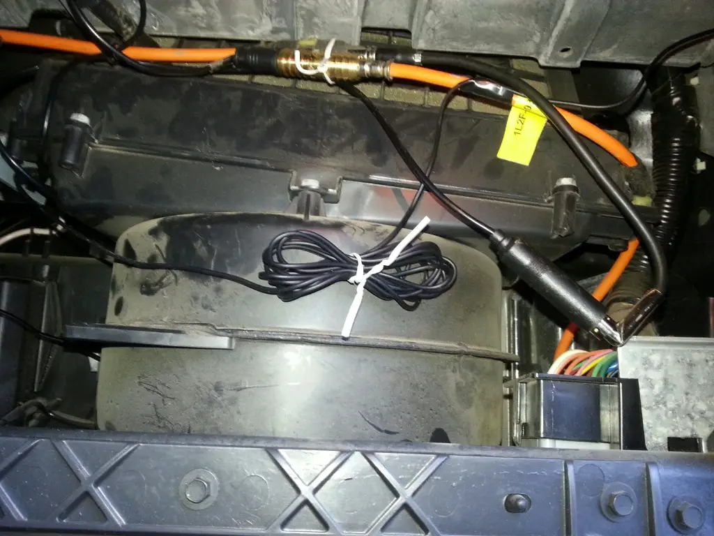

By interrupting the antenna feed I no longer have to deal with strong local stations breaking in over the adapter. For Ford it's necessary to buy an antenna adapter off Amazon or eBay but it's just a couple dollars. The pic shows where the factory antenna wire is (orange).
The BT adapter is the grey metal box and the white thing on the left is a 12 to 5V USB adapter in a plastic sleeve that I added so my phone power was also hidden behind the dash. I had to run a wire over to the driver side in order to tap into switched power (green/dk.green).
This adapter accesses most phone functions by using the one-button remote to activate the phone voice recognition. The adapter has own microphone for VR and phone calls. I mounted the mic to the left of the overhead console and ran the mic wire tucked under the front edge of the headliner and down behind the A-pillar where it joins the rest of the rats-nest behind the glove box.

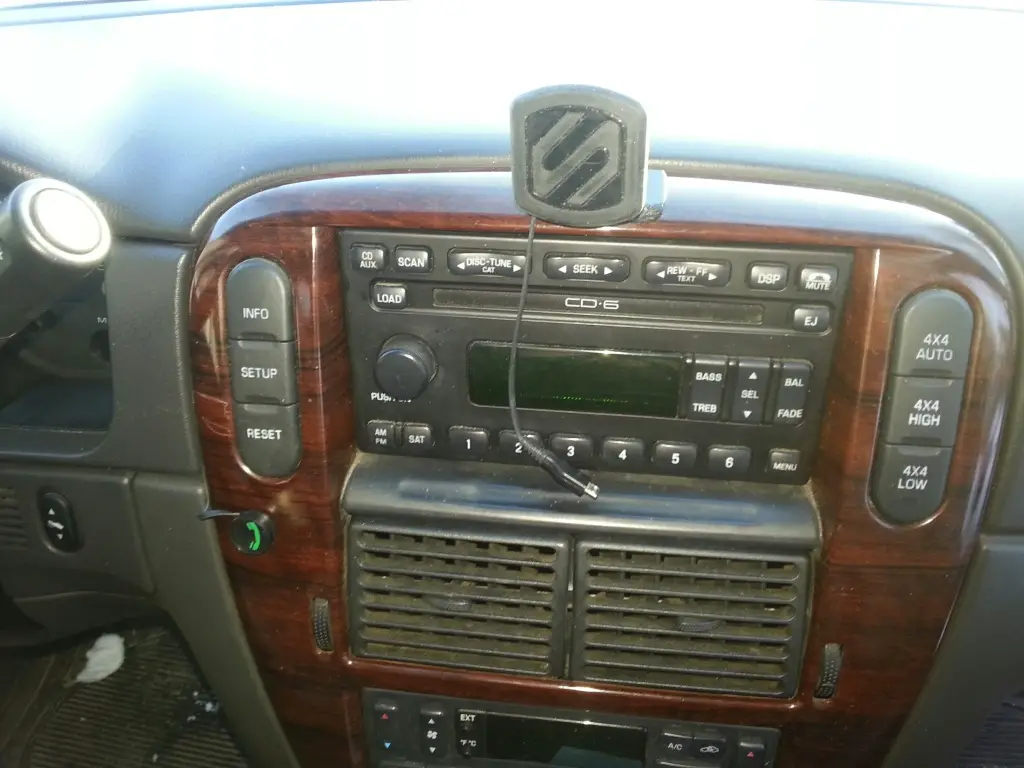

Here's the result. The phone mount is from Scosche and its a magnet that grabs a thin steel plate hidden under my phone case. No fussing with clips or springs. The USB cord and the adapter control button ("phone" symbol on left side of bezel) wire are hidden behind the bezel. Everything is pretty easy to get to if there is ever a problem in the future.
