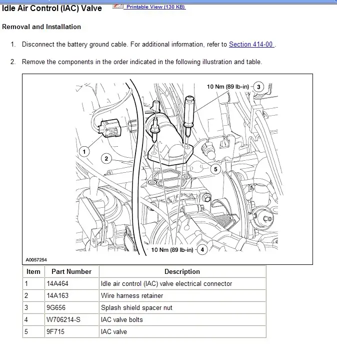

I searched and searched and found nothing...I only found the location but for an '00 which is not the same...or, is it?:(
I am receiving a new IAC tomorrow and want to know where to look...in theory it should be in the same place as the other models, right?
When I plug the new one and put in a new fuel cap, I should disconnect the battery for 5-10 minutes to reset the SES code, right?:rolleyes:
V6 or V8? Do you have a throttle cable???? Or is there a motor looking thing on the side of the TB? Does your engine look like the pic? If so i hate to burst your bubble, but there is none, no IAC on FlyByWire. . . ie no throttle cable.

Mine is a V6...4.0 SOHC
Have to change it quickly since it is dying on me...:(
Thanks guys...I just got the truck from the tranny shop back and they told me I have to get a new IAC asap...it is dying on me when cold...that stinks...
Will change the IAC today and hopefully that freakin' SES light will get cleared...:(
