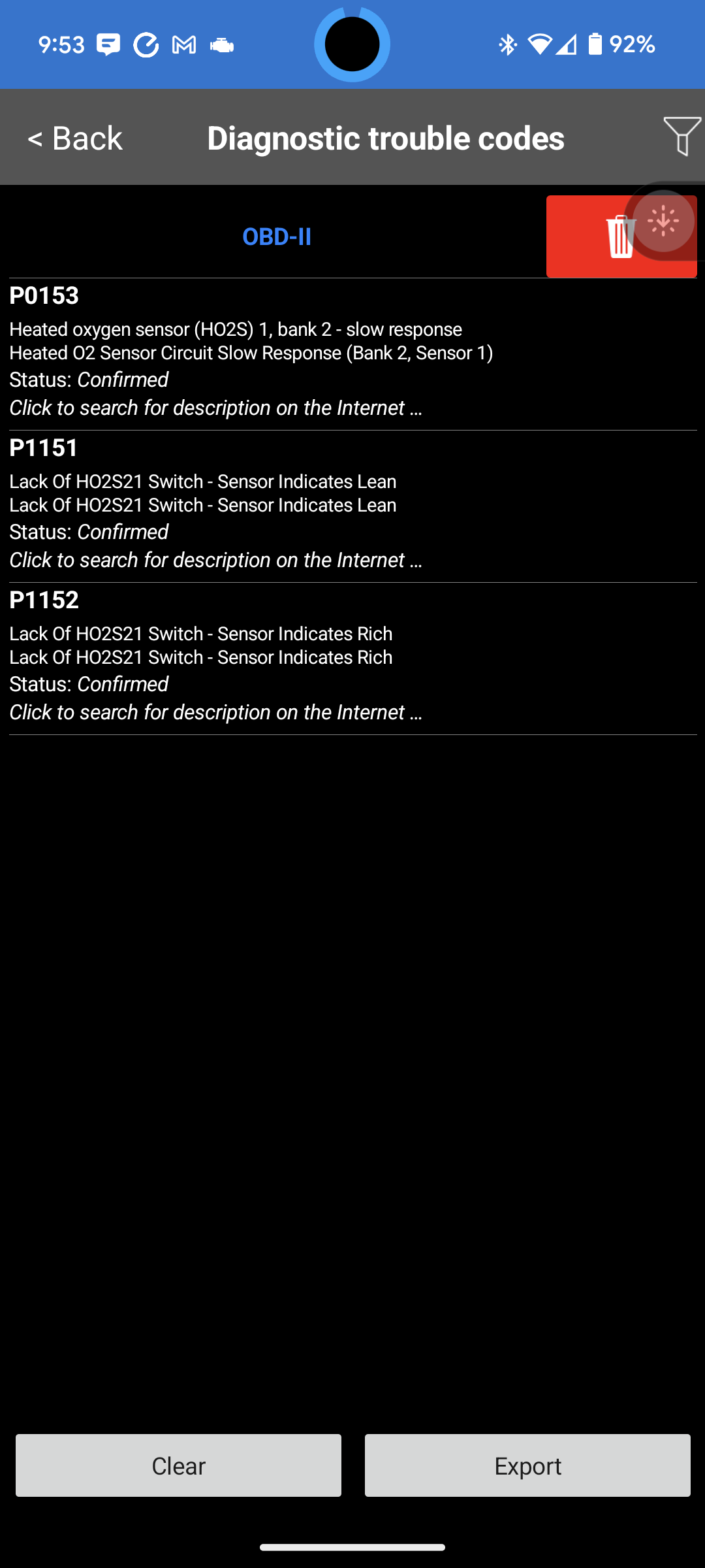

I need some help,
1998 Explorer 4.0 SOHC with 172K miles.
I'm getting error codes,
p1151 Lack of HO2S21 Switch-Sensor indicates lean
p1152 Lack of HO2S21 Switch-Sensor indicates Rich
and p1153 Heated oxygen sensor (HO2S) 1, bank 2 - slow response, Heated O2 Sensor Circuit Slow Response (Bank 2, Sensor 1)
rough idle sometimes and also dies sometimes after getting off the highway at a stop light.
Any and all help would be greatly appreciated,
Thank you
Id double check your fuel pressure, and make sure that it is ok, it could be dropping too low, causing the stumble and shutdown. Or you could have a sticky fuel injector that could not be firing everytime.
Inspect your spark plugs and wires as a misfire isnt always detected if a spark successfully grounds whether its on the spark plug itself or the block.
