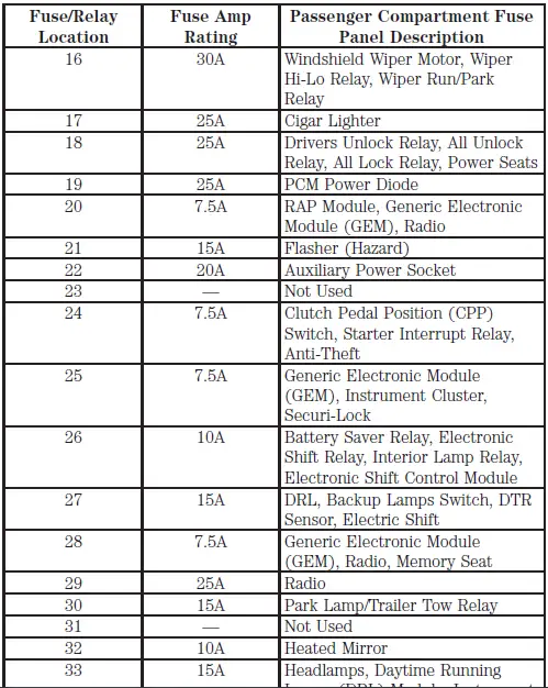

:mad:I was changing out my dome light bulbs today, and all of the suddent they shut off, i tried looking up which fuse it was for them but there not listed in the diagram for which fuse it should be. Any help please?
My 2000 manual says its fuse #26.
EDIT- It actually says fuse 26 controls the Interior Lamp Relay
Like I said, this is for my 2000, but since your only a year different, im sure its the same.
