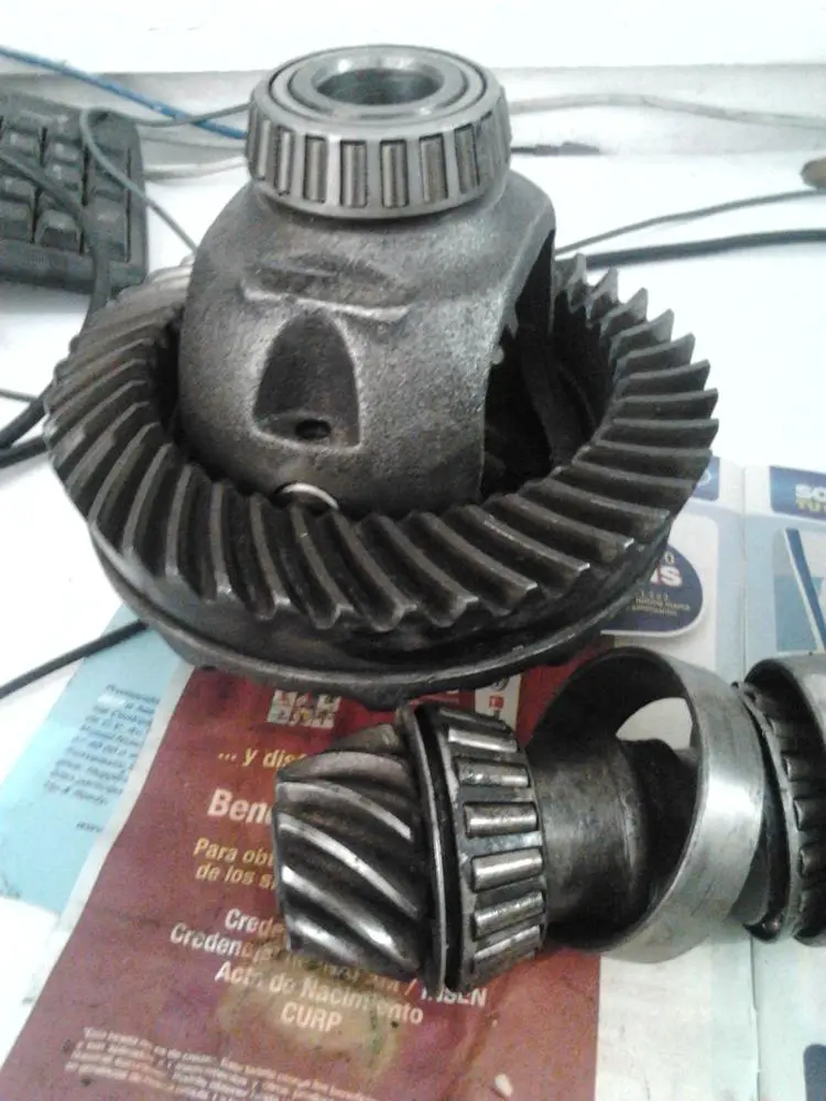

The equipment is OEM (Timken bearings, Spicer ring/pinion) it was extracted from another aerostar. I'm looking for the bearings/cups to see if they are still good to run or i have to replace them. Here's a picture of the whole thing:
Ratio is 3.73 Step 41 - 11. And just for show, here's the old one:
