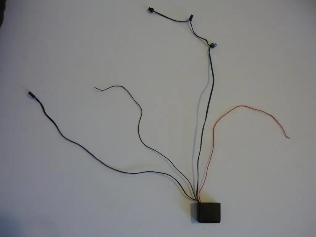

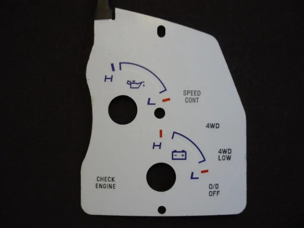

About 4 years ago i got these gauge faces for my 2000 mountaineer. I wasn't a member here yet but i read through the install write ups and thought it sounded easy enough. I ended up having problems, threw the gauges in a drawer and forgot about them until yesterday. I can get the instrument cluster apart, the gauges fit over the needles, but the wiring has me confused because mine are different than anyone elses i've seen.

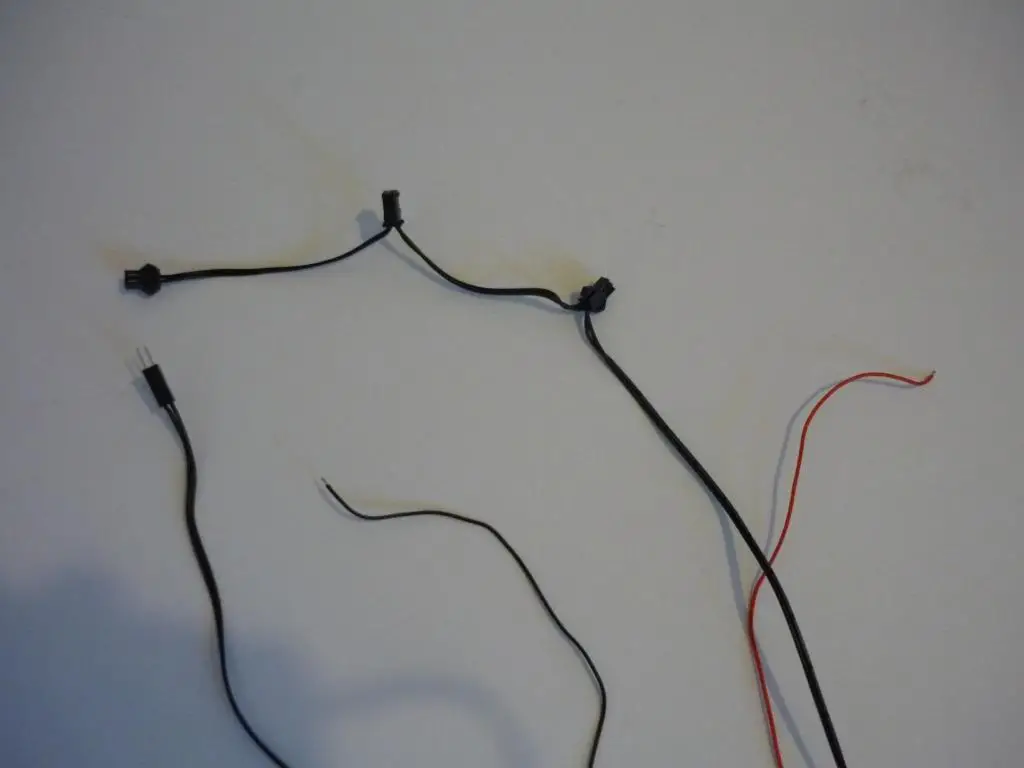

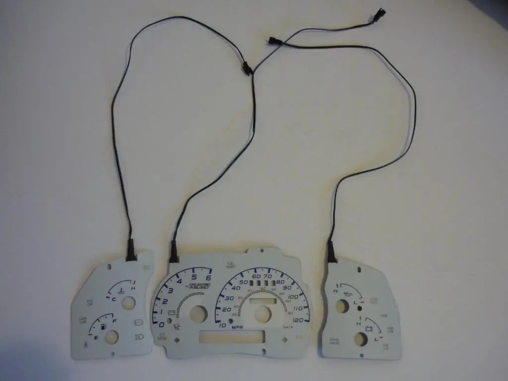

Here are the 3 pieces, each with a wire and plug at the end

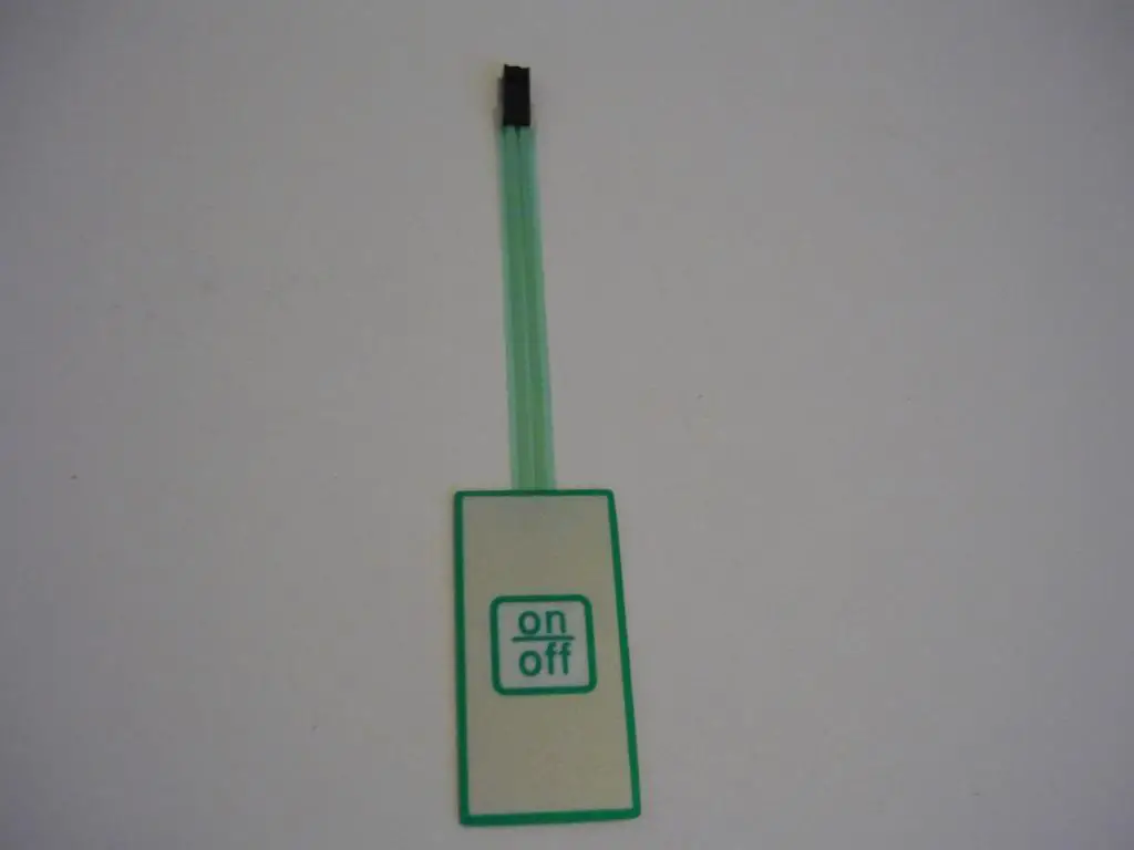

Here's a cheap looking button that came with it, i'm not sure what it's for though.

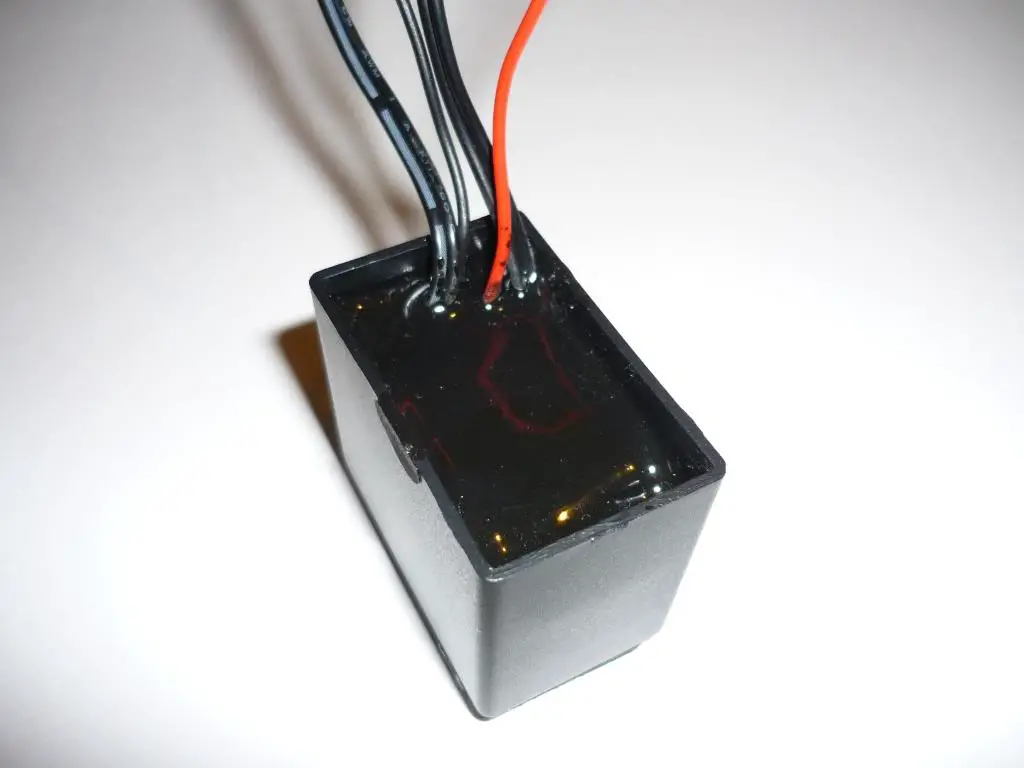

This is a plastic box with something like hardened resin holding 4 wires into it, and the box has some double stick tape to go somewhere behind the dash.
There are single red and black wires (for power source and ground), a double black wire that fits with the plug on the on/off button, and a double black wire with 3 consecutive plugs that fit the plugs on the gauge faces. I presume that i'd just have to find a wire to splice the red wire into, and ground the black wire somewhere...easy enough, hopefully even for me.

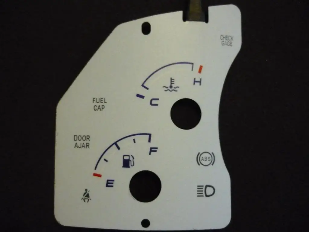

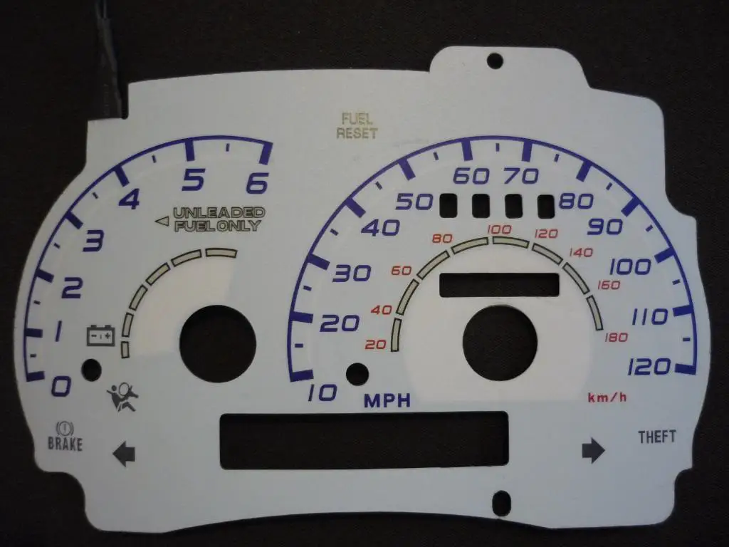

This is where i get really confused. There are some warning indicator lights on the gauge faces that don't match with the ones on the stock gauges...
...for example, the "door ajar" should be top center between the tach and speedometer, but on the new gauges it's far left by the fuel gauge. So did i get defective parts or.....? I don't know how i would fix this besides cutting out the misplaced indicators, but i shouldn't have to do that.
I realize after all this time i'm probably just stuck with what i have. Any tips? Am i right about how to hook the gauges up? What's the button for?
That's because the gages are for an explorer and you have a mountaineer, people have reported that here when they swap the cluster to get the white one
You need the one bigtig has in his write-up:
Dead Link Removed
Those may be for the 95-97.
So in both of your explorers (jad's 97 and section's 96) these gauges would work? Still a little confused as to why an explorer and mountaineer would have different gauges, just doesn't make sense to me. But whatever...not a big deal. I saw the ones bigtig has when i decided to get these years ago, i liked these better.
I think its a 95-97 VS 98-01 thing and not an Explorer VS Mountaineer. I added the white '01 Sport gauges to my '96. The lights were all in different places. But it worked perfect in my '98 Mountaineer.
"No check engine light. And everytime a door would open the "gas cap" light would go on instead of the door ajar." is the problem I was having in my '96.
So if the 'gas cap light' on your new gauges is where the 'door ajar light' is on your stockers... you have the 95-97.
Ok, well i'm glad that's cleared up after all this time...maybe they were advertised wrong on ebay, i can't remember.
While I was just checking for pics, I noticed a lot of those on eBay were listed as 95-01. Which sucks.

That is a manual on/off switch. I have the same gauges as you except they are for a 91-94, not very happy with them. They worked great and looked fine for about 3 weeks then the little black box with the epoxy encapsulation went out (power supply), then the plastic film on the gauge overlay's started to lift from the gauge faces themselves. i'm going to wait until spring and take them off and do an all LED conversion

Wires Connection: Power and ground leads are hardwired to the power inverter (black box). The power lead (red wire), which has an in-line 1-amp fuse, should be connected to your vehicle's dash lights power wire or cigarette lighter power wire. While the ground lead (black wire) should be connected to an existing ground wire or any clean metal surface.
2-pin female connectors are hardwired to the power inverter. Connect each gauge overlay to these connectors.
Power Inverter, Dimming Switch or On/Off Switch Mounting: (If comes with the kit) Using the supplied self-adhesive foam pad, you can mount the power inverter and dimming switch or on/off switch on any flat surface. Each kit comes with either Dimming Switch or On/Off Switch, but not both.
