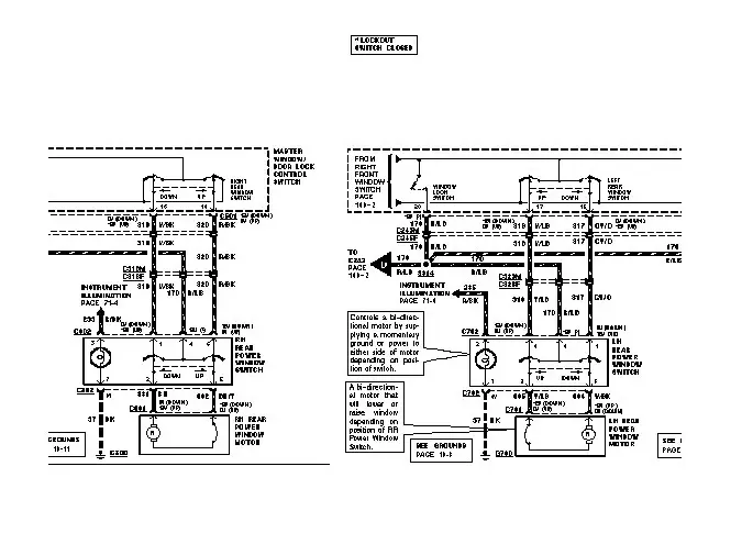

found a wiring diagram but I'm having trouble uploading.
try this

Well, just put +12VDC to the yellow wire and the other lead (I cut the door light leads hanging off the door) to the red wire on the motor and ... PRESTO ... the window went right up.
So now I know that it is the Yellow and Red wire at the switch that is not getting + power. Will track that down later ... at least I got the window closed so I can drive the Exp in the rain tomorrow :) !
