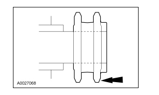

the only thing you could of done if the timing cover is on right, is install the lower double sprocket backwards.
yea but wouldnt it be the same width either way?... i guess ill pull the cover tommorow it has to be something visable when i pull the cover
no it would not, the double sprocket, behind the crank gear has one side longer then the other, what happens is that is what the damper bolts to.
if its on backwards, you will have more play for the damper to go into.
goes on like this.
ok my timing gears dosent have the sleeve part on either side... an timing mark is on one side so it has to be on right ...but i noticed the sensor wheel would be rding against the chains also as it dont have nothing to stop it before hitting the chains...i love fords but the 4.6 is driving me crazy lol
did you put new gears in? if yes, compare them to the old, imo they are wrong.
yup had a wrong sprocket ..damn ebay...it didnt have that extra lip on it like shown in your pic faceing outwards...
