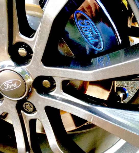

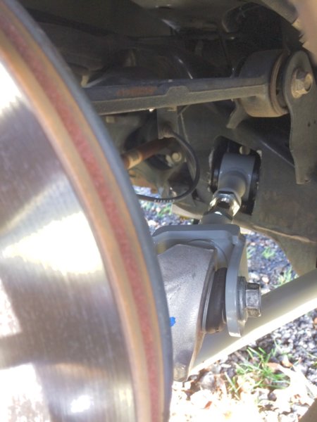

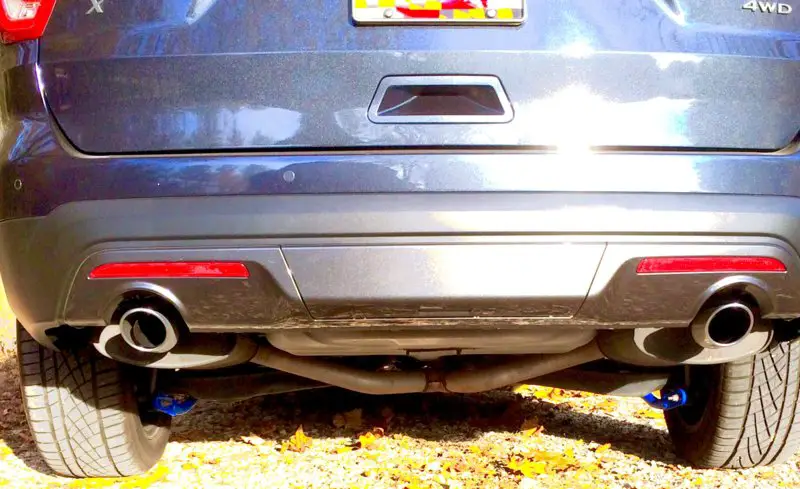

Pure Automotive Performance In Millersville, MD did a great job installing my new Steeda suspension pieces this past Friday. The change in handling is amazing! On the way home after the installation I was in the left lane of a two lane off ramp when a pickup truck in the right lane decided he wanted back out on the main road. Next thing I lnow I’m in the median strip with a stopped car up ahead, the knucklehead in the pickup moved all the back to the right lane and I was able to avoid a bad day. My X handled that sudden maneuver without any violent swaying. I had complete control. What a hell of a first test for the new suspension, thanks Steeda! Even making a simple 90 degree turn from a traffic light or stop sign you feel the difference. I am disabled and turns and curves can cause me some serious discomfort when doing the speed limit or a little above. This suspension improvement not only has made a major difference in the X’s handling but also in my overall comfort while driving. This has been the best improvement I’ve made to the X! I highly recomend it.
