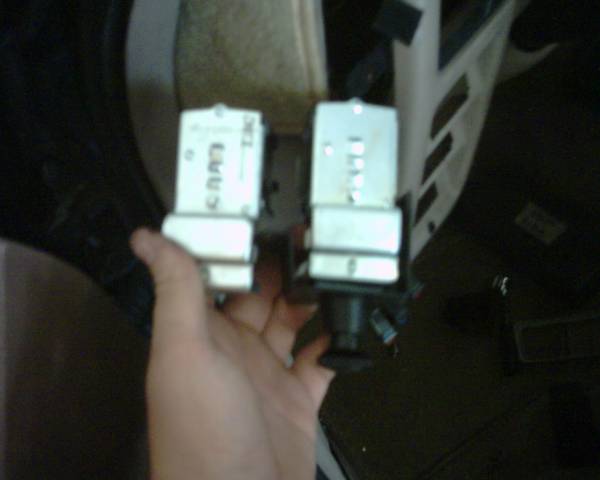

i would put $ on the switch, some idiot me wired driving lights into the parking lights, it worked for a year, then one day no lights same as your buddy. any way the switch for a 1st gen was $3.85 i do not know what yours will run, i did have to take the black face plate off and knob to put them on the new one,
ps bring your old one to the store

these may not help but the new one is on the left and looks nothing like the old till you rip it apart
