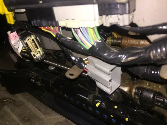

Here is the underside of the drivers seat:
I have to confirm, but i'm pretty sure mine has the same 2 harnesses plus the yellow airbag plug.

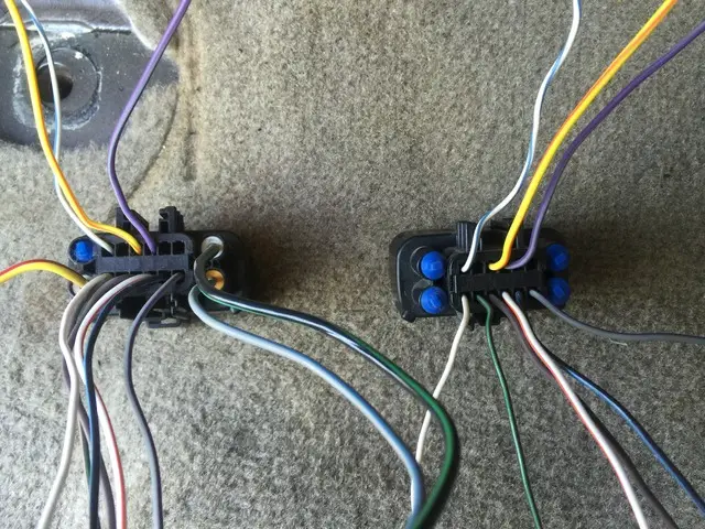

Here is the passenger seat:
Sorry for the weird angle, I had to put my camera down there to snap the pic. The wires are cut where the black harness leaves the picture. So I would have to wire that whole harness. Anybody know what the wires are for? I don't know if the seats are heated.

should be airbag, seat pressure sensor and seatbelt

I thought the airbag had its own yellow connector? I could be wrong. But with the power seat, is it essentially just adding a power and ground to get it to function or is there more to it?

Picked them up, have mine ripped out and I also just found out from the tag on the seat, that they're heated. Would love to figure out what modules and such I need, but that's low on my list. The harness that my X has is identical minus 3 wires. I would assume power to the seat motors, power for the heat which would be controlled by a standalone unit? And a ground which is shared by both?
One is a large black wire w/ green stripe, 2 is a gray wire with blue stripe and then the other side has a yellow wire with red stripe. Pics as soon as photobucket finishes
Just plugged drivers in and have no movement. There is a second large connector on that seat that I do not have. There is also some kind of module on the bottom, is that the heated seat controller or would that be for a memory seat?
