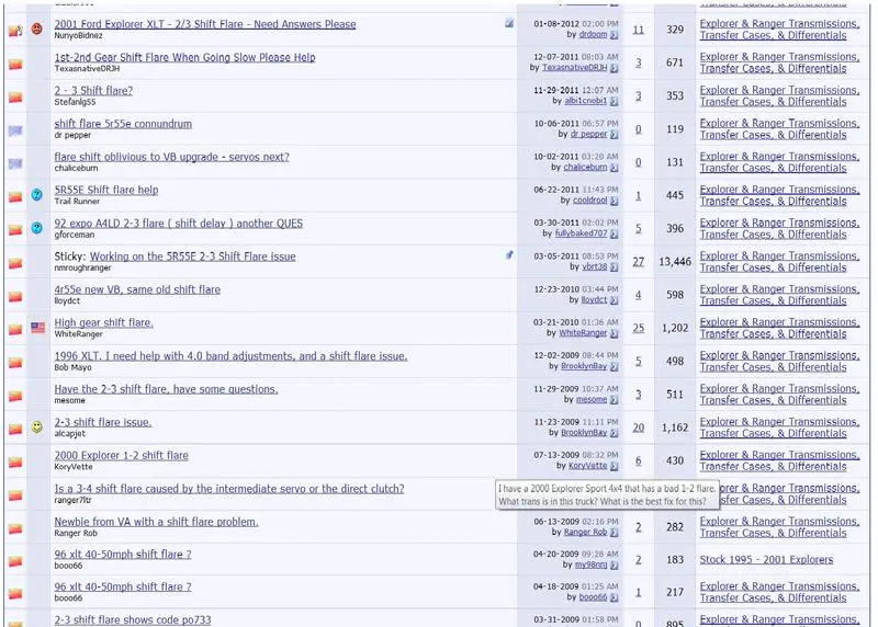

I don't think that's normal. Probably getting worn.
I'd just keep running it before I got a rebuild. It will kick the CEL when the problem progresses. And even when that happens you can do what I did for two years and that's shift it manually, lol. I did that for so long I had trouble breaking myself of doing it with the new one.
Well, i do shift it manually, but i don't see how that would help because it still has the same delay. It's about .5sec less with O/D off though. Could it just need a service? I went to dealership in town for lulz and that's what they said it could be.
In all fairness, those are all V6 related.
Because the V8 have a better transmission, the 4R70W.
It doesn't mean that it can't be damaged. Especially if, the OP has some specific driving habbits.
