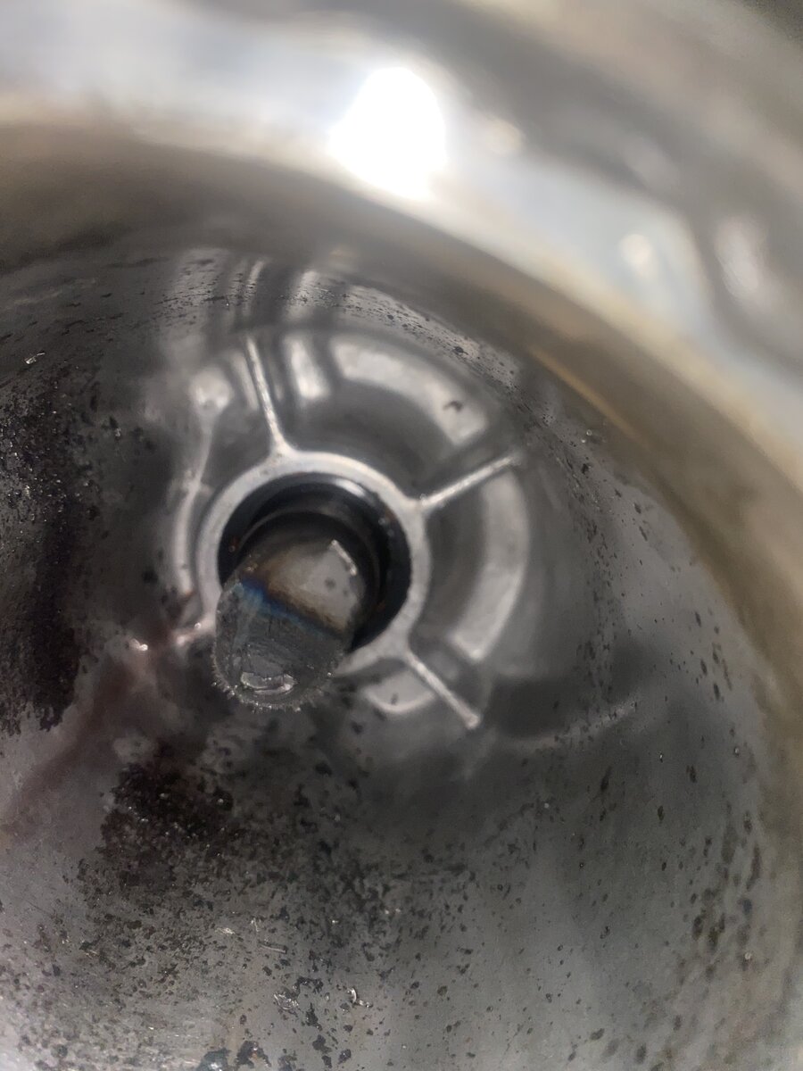

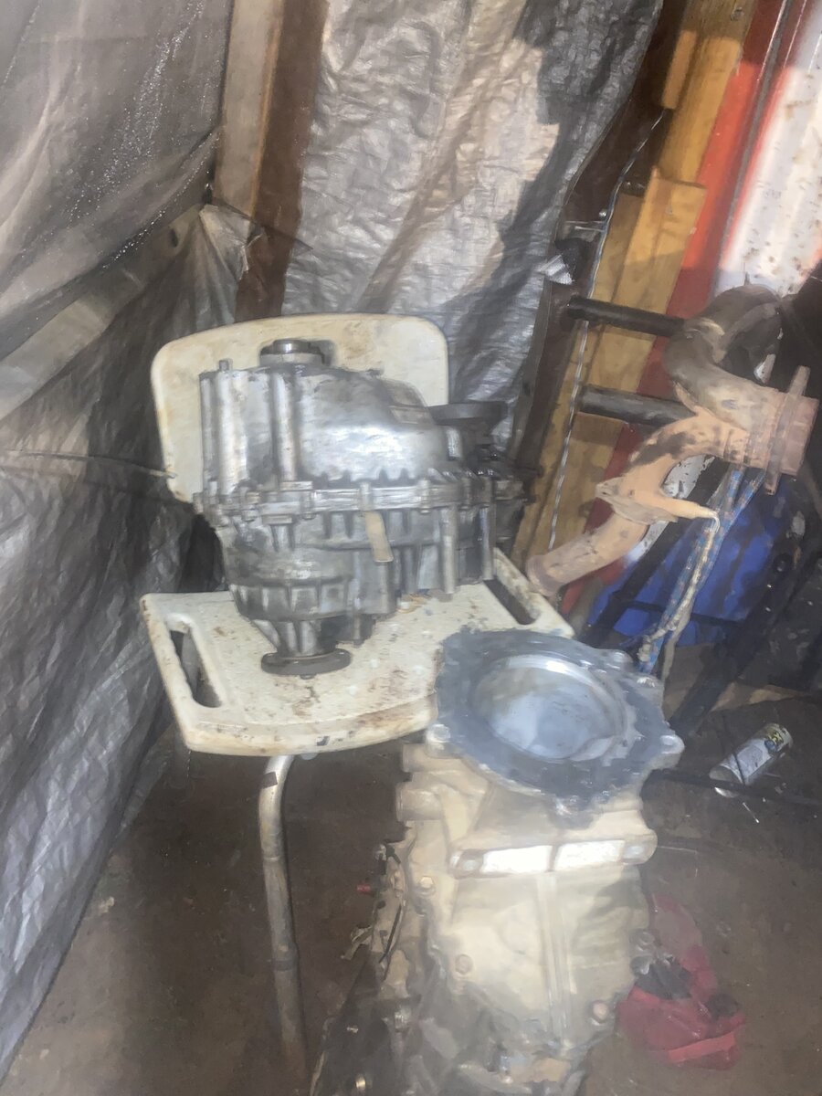

Hey guys I just got the trans and t case out found that i did snap the out put shaft clean in half so I was wondering if I should go get a new trans from the junk yard for 200 or should I see about getting that shaft replaced if possible the t case on the other hand I think I need to replace for the 2nd time this week I shook it and hear metal rattling in side so maybe a gear broke or something

I’d puke the oil out of the t case and look for metal. I’d take a risk on a user manual transmission. They are relatively stout.

When I took the fluid out of the t case it looks like it’s metallic red🤣 but no chunks or even shavings but I can hear rattling inside I’ll probably bite the bullet and go get another one to be on the safe side and yeah there’s a lkq junk yard near me they only want 200 for the trans and 130 for the t case do any of you have any good recommendations for a good throw out bearing/slave cylinder mine was making a lot of noice so I might as well cha get it while everything’s in peices
