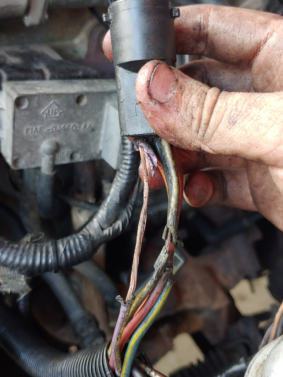

I think that one goes from trans to connector near charcoal can with no obvious fritction points, then loops through conduit over against top of firewall eventually back around through the firewall on passenger side. Check the firewall passthrough/bulkhead. where harness bundle ceases to be conduit and just wrapped (description of mine).
Don't know if it is common point, just looks most likely to me.
Uhhhh, yeah.... That explains everything. Big long exposed wire is the purple and yellow TCC wire.
Looks melted, not chewed away. Like chemically melted 😳.

fothermu.... And this really shifted fine before warming up?
I don't think brake fluid is supposed to effect the insulation but long term....maybe. And the master is about right above so unless anyone else has insights... Is it soft and gummy or brittle and hard? Or both?

Soft and gummy. I had a power steering leak for a long time that I fixed a few months ago. Never had a brake fluid leak thought. Maybe I did, and just didn't know it. I redid the entire brake system last year. I had so many wires like that. My AC high pressure switch pigtail was like that too. I probably went though about 15 to 20 wires, cutting, adding heat shrink tubing to cover the exposed wire, soldering, then covering with heat shrink. Not a fun repair, but I had all the tools and supplies on hand, so it cost me nothing.
Now I notice a substantial increase in power, I wonder if that was also the cause of my fuel economy problems. I'll get back with everyone. Truck drives like it's brand new now.
