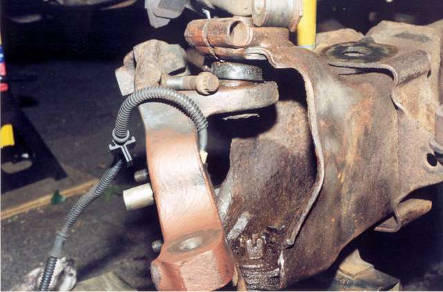

Ok i had some time to look into this issue. It was one said that i should check my u joint on the drivers side where i hear the clunking (spelling off sorry) i did not have time to look at this untill now. but does any one have a picture where that u joint would be. its enclosed but i think thats the issue
any help would be great
If you turn the wheels all the way to one side the steering knuckle will open up enough for you to inspect the U-joints. The stub axle U-Joint is located in-between the upper and lower ball-joints where the TTB begins.
ok will inspect after work. Thank you
