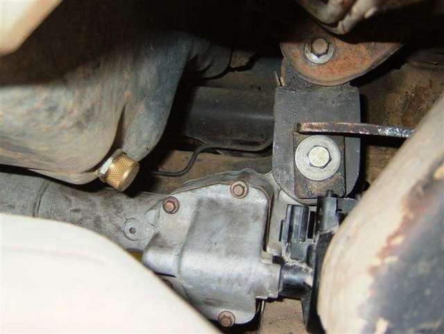

Just out of curiosity, why do you need a body lift for the CAD diff?
Do you have to lift the engine a little to clear the CAD unit?
This picture from Mountaineergreens thread shows the clearance between CAD unit and oil pan, With superlift drop brackets installed. The clearance looks tight, but it might fit under the v8 without the drop????
The cad was never offered with v8 so fitting it is up to you.
Here is the thread.
http://www.explorerforum.com/forums/showthread.php?t=187449&highlight=cad
