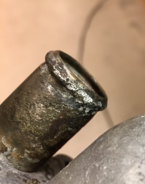

Thanks for the tip, I’m pulling it off and taking it to work with me today, hopefully I’ll get a chance to screw around with it. Oddly enough I’m womdering if the leak was from the upper radiator hose to the housing. Jiffy lube got rid of my constant tension clamps and replaced them with cheaper looking screw type ones. I’m going to change that out too and hopefully a combination of these things will solve my problem.Once the surface was true from the file then a new gasket did not leak. Just used dab of RTV to hold in place when assembling.

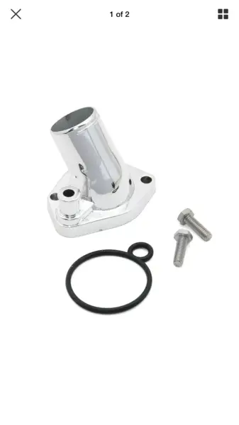

I ordered a new tstat housing from eBay made by Mr. Gasket for $23, and it comes with 2 o-ring gaskets versus a paper gasket. I’m not sure how I feel about that but I’ll give it a shot, free returns, of course I don’t know if that goes for installed parts. My biggest problem with it is the 45 degree angled pipe that hooks into the upper radiator hose. The stock housing is as you all know a 90 degree bend straight up. I don’t think the angled pipe will interfere with anythihg but I won’t know till I put it on. Consequently all the other manufactures of this aftermarket tstat housing (dorman, gates, etc...) all use a 45 degree angled pipe. Probably because most of the other ford vehicles that housed Windsor V8’s of that time has a tstat housing with a 45 degree upper pipe, just a guess. I’ll hang onto current housing if for some reason these angled styles won’t work. Stick my original plan if filling in the bad spots with jb weld but hopefully won’t come to that.

becareful with those thermostat housings with orings the ones i looked at butt two orings up against each other instead of each one having its own sealing area, pretty poor design.
This is the one I bought, unfortunately no pic of the back side. I’m assuming there’s going to be a groove for each ring to sit in and then just torque it to spec. I’d prefer it had the paper gasket, like you said it seals up more area. Luckily I can return it if it seems questionable when I get it, then I’ll just buy the Dorman version that utilizes OE gasket. I wonder if you can still use an OE gasket with this housing, that would be nice. I also have an 07 Ex with the 4.0, I’ve had two t-stat housings go bad on me, they were the plastic type. So I opted for a steel s-stat housing, it came with o-rings big and small for the openings but it also came with a cork gasket that sat below the rubber o-rings. I was very skeptical but so far there have been no leaks in roughly 2 years.

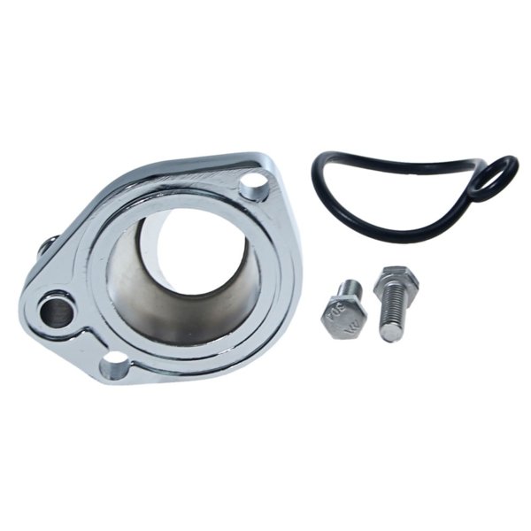

that looks like the one i was looking at too, im not 100% but from what i saw they had their own separate oring groove except for where the two groves met and then it was just open so the two orings were together. The dorman one is complete junk imo i have that one now, i had to sand the new part down to make it flat and to work out tons of gouges in the sealing areas after 5 months the pressed in bypass hose part is leaking from where its pressed into the body. it has a lifetime warranty but i mean cmon still have to lose coolant and buy a gasket/rtv. the dorman does come with a gasket but its pretty low quality.
when the new one comes in post up whether the two grooves stay separate because if they do i bet it would seal up pretty well. we need some quality aftermarket ones because the dorman one is junk and the oem ones are too pricey

As soon as I get it I’ll post pics, but it’s probably the same one you’re looking at.that looks like the one i was looking at too, im not 100% but from what i saw they had their own separate oring groove except for where the two groves met and then it was just open so the two orings were together. The dorman one is complete junk imo i have that one now, i had to sand the new part down to make it flat and to work out tons of gouges in the sealing areas after 5 months the pressed in bypass hose part is leaking from where its pressed into the body. it has a lifetime warranty but i mean cmon still have to lose coolant and buy a gasket/rtv. the dorman does come with a gasket but its pretty low quality.

Hey @tripog I got the tstat housing today and was checking it out on my lunch break. It is groved in the rear and I actually think it would seal up well. However I decided to return it for 2 reasons, I feel like the 45 degree angle is to close to the belt which I don’t like. The next thing I had a problem with was the size of the bypass pipe, it was much smaller than the bypass pipe on the original housing.
I opted to buy an OEM housing off of amazon for $63, https://www.amazon.com/Ford-Racing-...M-8592-M90&dpPl=1&dpID=41izDhYTOkL&ref=plSrch
thats good, im sticking with the oem one too. better off keeping it clean than replacing it as i haven't found any quality aftermarket ones.
