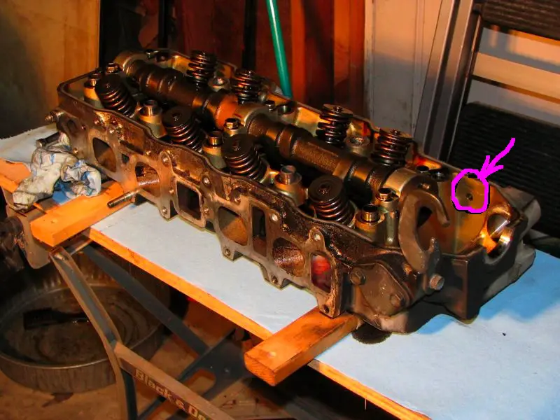

well, i helicoiled it, and retard timing to 3-4*
