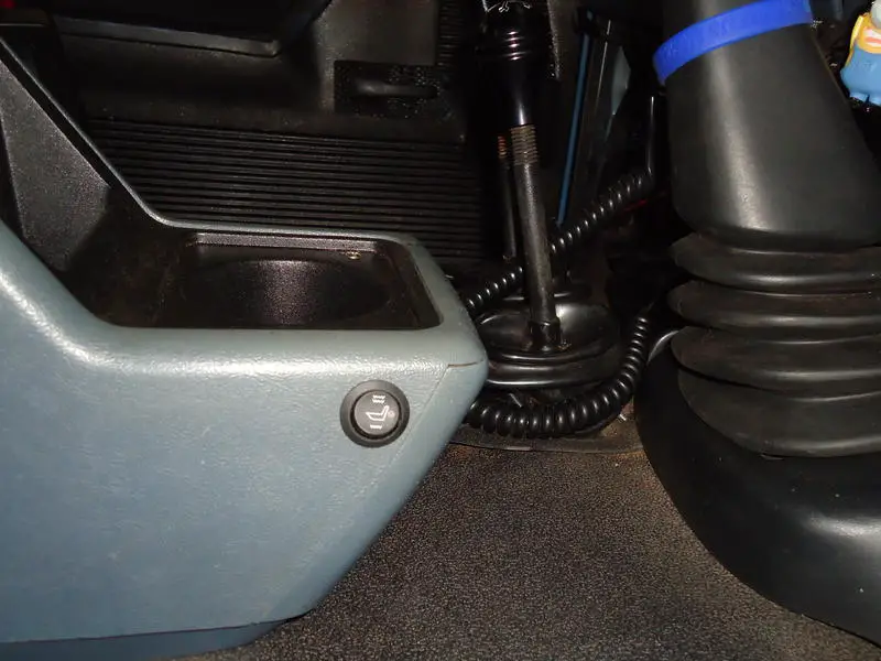

Got that part, what's the little switchy poo for?
. . . seat heaters . . . for these Corbeaus that were installed last September.
. . . but like most things, it wasn't just a simple wire up the seat heater issue. . .

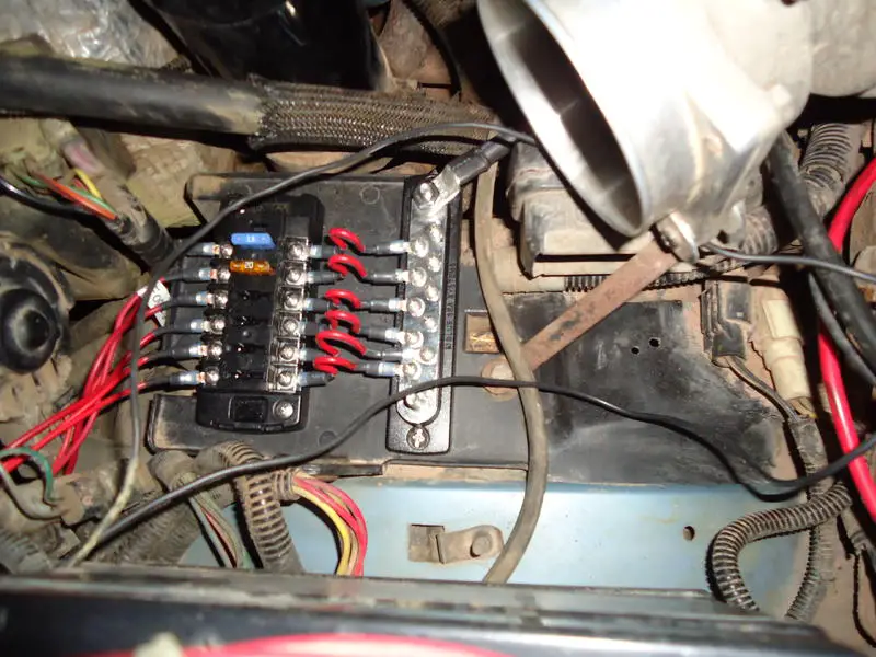

It was part of the "add an auxiliary battery with isolator switch, relocate the radiator overflow tank, relocate the ARB compressor, add a separate fuse box and bus bar, clean up 20+ years of rat's nest of wires that are fairly well hidden in half a dozen wire looms, mount and wire the inverter (I've had for over a year), throw some 12V outlets to the cargo area", and oh yeah, wire up the seats. . .
Here's a progress pic:

I think I can come down on Sunday and help for a little while if you would like (I'm on call and we have a network migration at work on Saturday). Comes with a wiring diagram :scratch:
Phil -
Thanks for the input.
Got one of these: http://www.westmarine.com/blue-sea-systems--350a-compact-battery-switches--P009_272_004_501, with the 1,2, 1+2, Off switch. Not as concerned with the additional flotsam of the other unit - - not running multiple sensitive components (Fish Finder, Radar, etc.) to protect. . .
Will let you know how it goes when I get back into it tomorrow PM, but appreciate the offer for assistance this weekend. . .
Paul
'91 Sport
I still recommend an isolator of some type. Always charging, only discharge when switch is on.
