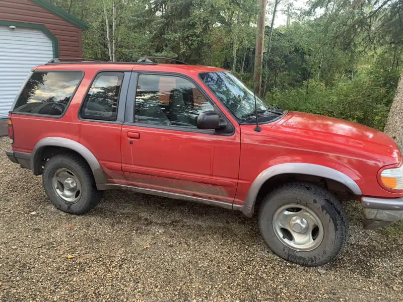

Hey guys this is my first post on here. I picked up a mint 1997 2door awd sport with the 5 speed manual. I’m having a few issues and wondering if someone here has had the same and solved them.
Shifting from 1st (at a complete stop) is sometimes stiff and I need to use some force or shift into second then first. This is the same with reverse.
Sometimes this happens sometimes it shifts perfectly.
ABS vibration type feel/sound all the time when I brake and come to stop
Appreciate the help and can’t wait to drive this old girl for years to come.
