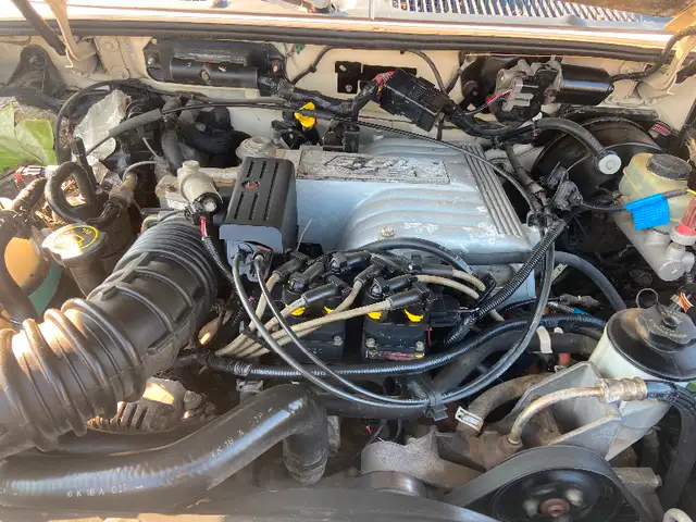

Somebody has changed the coil packs on that 302 probably chasing a misfire

-Running rough, really bad plugs, .090 gap on a few, and they were messed up. runs not bad now, but throws a occasional code P308. so might have bad plug wire, the number 8 was the worst fitting of all. Auto stores here dont have aftermarket plug wire sets available, so will have to source some.
May be suspecting a injector as well, not sure. I used a maxsimizer obd setup, all cylinders under load are pretty even. better than 2002 GT mustang.

Misfire code that shows up quickly is usually an injector issue
Could also be a valve/ compression issue
Good idea to keep an eye on the spark plug in the cylinder in question. Can read the pounded if it’s dry, wet (with fuel) or gets oily deposits on it
Rockauto has United motor product wires for $45 plus shipping they are about 3 times as good as the parts store offerings
November 2024 update, was throwing P308 codes every day. ordered a set of NGK spark plug wires, i only replaced the #8, and it seems to have fixed it. No codes, in 10 days. I will change the remaining plug wires later when warmer. I liked the ngk wires , they were numbered as well. Only bad thing is the clip on the valve cover broke off when i was unclipping the old wire, have ziptied the wires up a touch.
