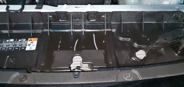

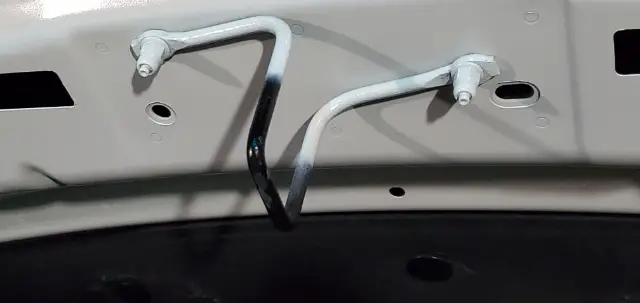

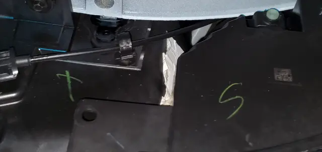

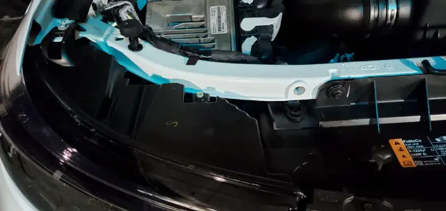

Just purchased a 2020 Explorer ST from a dealer my father worked at for 40 years. It only has 12k miles on it. Had a clear carfax. However after getting it home and looking in detail under the hood. I noticed on the top front trim above where the radiator is. There are markings in white, that look like alignment markings to me. As if the truck was taken apart previously. So then i saw black spray paint over spray on the white paint in the engine bay. Only to find it was from someone spray painting the hood latch hook, lower part, black! Its also a Ford CPO. Looking a the VIN. was one owner, which is the dealer I bought it from. However, looks as though it was a lease.

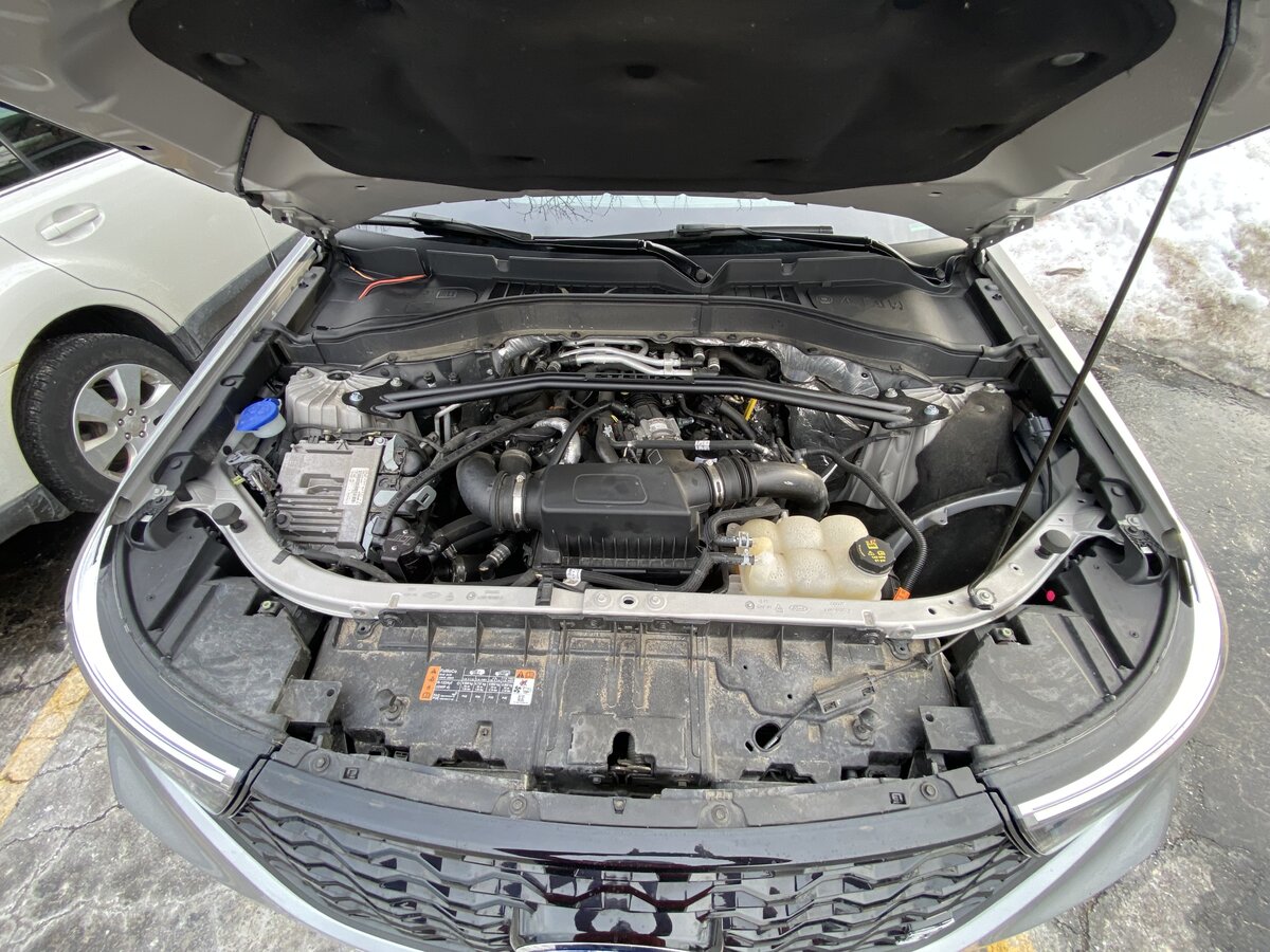

i am hoping someone here. Would be able to tell me. what do you think was taken apart for the front black trim in the engine bay to have alignment marks. I also looked at the support bar in the middle of the engine bay. Drivers side bolts never touched. Passenger side has marks on the bolts like a socket was on it to take it off. Truck is still under new car warranty. Drives fine. Not a scratch outside or inside. Just really bugging me. what they could have done and not document it.

the t and s are factory marks, the spray painted part is weird would have to check a couple of other light colored models to be sure but you can tell repainted panels. The buffers leave rough edges were the seams are

What was the build date? If super early, there were some wonky things going on at the Chicago plant. Probably still are, but especially the early ones. I have a 2020 ST too, built 6/2019. Maybe when I have better lighting, I'll take a pic of my engine bay.
Yeah I just looked at our 21 SAP and it has all those same markings and it has never been wrecked.
Bought new in Dec 20 with 30 miles on it.

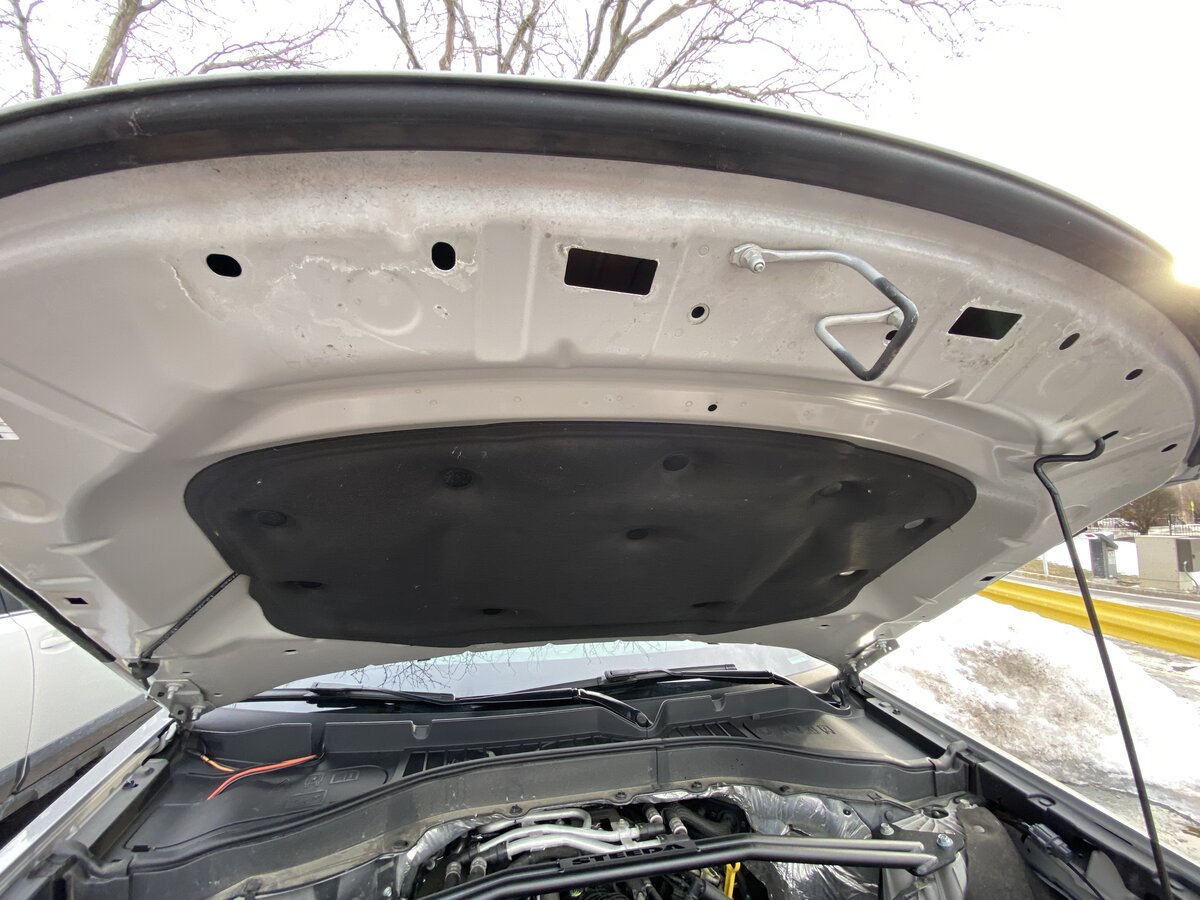

I have a very early 2020 Limited. My hood latch is the same if I recall correctly. I think it's just sloppy paint work in early production,
November 2021 build of my 21 King Ranch has those marks and the hood latch looks like that too!

The build date was 8.07.2020. I am assuming that is a late build? its number 20059 in sequential order. THanks to every one that replied. Makes me feel a lot better. I was all excited and especially after spending 53k to purchase. Traded in a lincoln MKX with the 3.7L in it. I thought that was fast. This ST blows that out of the water times ten! It just wants to go.
I just find it odd that if they do spray the bottom of the hood latch black at the factory. The over spray is really not clear in the pictures as it was at night when i took them. The over spray hit not only the front white upper frame but also hit the driver's side shock column/mount.
The color is Star White. Aside from the over spray. The car is spotless. Came with smoked headlights too!
Why would that be hard to believe, they spray painted it a dark black rubberized color to make it less noticable when you latch and unlatch it over time. It hides the scuff marks. The over spray is not that bad as the Chicago factory is known to be an issue as it is Chicago. The shock towers are black and framed color.
To me, it looks like the overspray is white, not black. :)

It is a black latch and over spray is present on all the ones that have verified it in this thread. Maybe they laid paint on the under-section of the hood last as the engine bay is black like the latch, which indicates to me that they are not painting the vehicle till most of the vehicle has been assembled. Maybe at the least they are painting the under-section of the hood last to match the vehicle.
Sept 2021 build with the optional painted or over-sprayed hood latch.
I also removed all the marks, whatever they were, looked like inspection marks to me.
View attachment 426465View attachment 426466
my latch is the same. the alignment markings may have rubbed off with cleaning.
thanks... see where your bar is showing on the drivers side. Right there.... My shock tower is white. same as the car. But it has over spray black on the white paint. From what I know now to be the factory. I was initially worried. as a friend came over to look at it since i just got it. He couldn't believe that the factory would be that sloppy. that is what got me more concerned!
