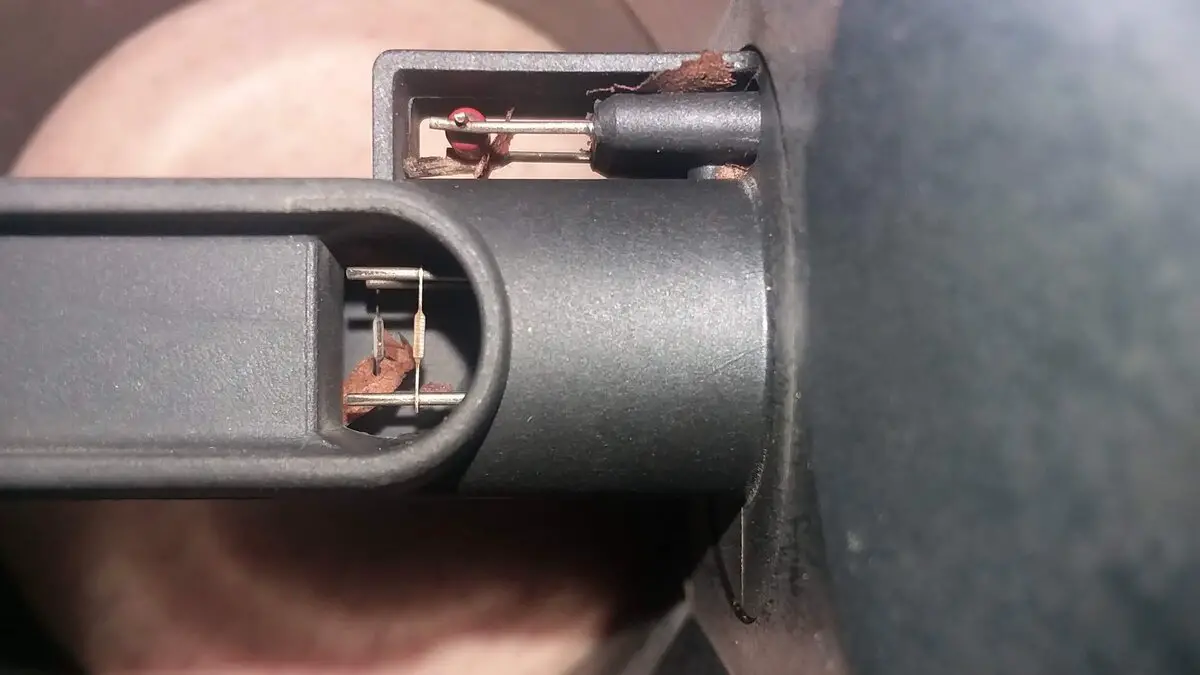

It would probably be a good idea to give a go-over to the MAF element with some MAF cleaner spray being it's been taxed by all that debri...could have some residue on it .....
Did that before I put it all back together, vacuumed the airbox out also. So far so good.
Sorry for the delay, but the problem is finally fixed!!!! After several months of trying to figure out what I was missing, and replacing the fuel pump, coils, and spark plugs and wires. I decided to look at the MAF.....?..bingo it had several small pieces of leaves in the hot wires, cleaned and now running the best it ever has..thank God. That will teach me to neglect the basics lol merry Christmas everyone and thanks again for the help.
Everyone basically on site knew and assumed you fired the gardener's before you did all this...basic 101 stuff...car
repair stuff that is.....Oh well....I would not drive to DC with that going on.......LOL
