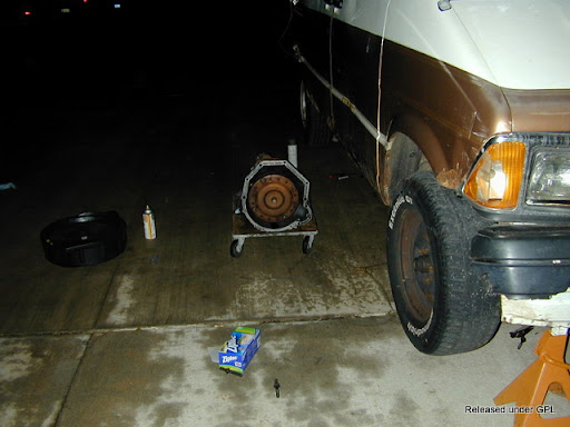

The tranny is out!

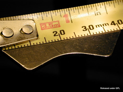

But what's THIS damn thing in the bellhousing? Closer look....
http://lh5.ggpht.com/_sm3FdBpsKcw/S1kMgsg50iI/AAAAAAAAAdM/zET5rYgaz5g/*******%201.JPG
Well this sucks. Haven't even cracked it opened yet and I find this ******* hanging out in the bellhousing. Wonder what it's from? Could be my starter, but I'm not convinced the starter would work while missing a piece this large....:rolleyes:

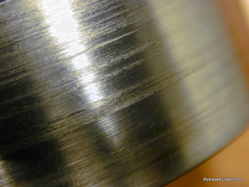

The input shaft....Anyone think this scoring and pitting is a big deal? It passes the fingernail test....
This is an official ATSG Transmission Chair. Sure, okay, that's a lie. But the first time I rebuilt this tranny, this chair was involved thusly. I still have no engine stand.:(
Using a breaker bar on the bellhousing bolts....

The torque converter should always be replaced in a rebuild as well as flushing the cooler & lines of any debris. The damage in those pictures makes be believe that the front pump gears were either misaligned or not aligned at all from a previous rebuild. Was a front pump alignment tool used on the front pump? Use a very fine grade of sandpaper or an abrasive pad to smooth out the input shaft.

Any Ideas about that 5/8ths half-ring debris?
I suspect that the piece might have broken off from the inside of the torque converter. Don't take any shortcuts on aligning a rebuilt torque converter. You will need to use the proper alignment tool to prevent future damage to the torque converter, shaft, pump, and bell housing. Unfortunately, Glacier stopped loaning tools a while ago, so you might have to see if you could borrow one from a local source. It might be worth it for you to purchase one for future use.

Well, it did not come from the Torque Converter....Here's the pictures:

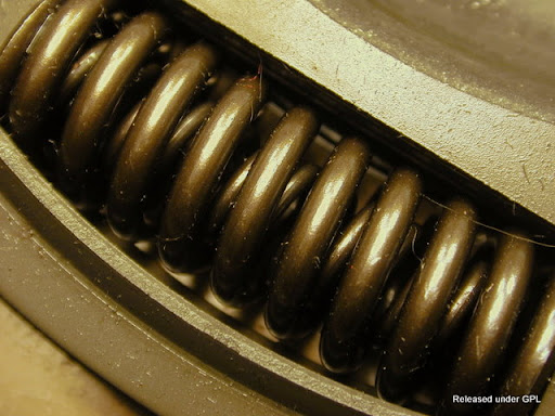

And, just for the mechanical beauty of it, here is a closeup of the spring assembly:
All of the spring assemblies are likewise intact. But after seeing the inside of a TC for myself, it's clear why you get a core on them....The re-builders must have a horizontal spindle they can put the TC onto by the snout, rotate it under a plasma cutter and break it down in about 20 seconds... I want one!
