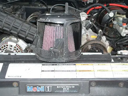

Since you have a '97 also, you should have the conical filter airbox like I do. Pop out the snorkel and cut a large hole in the bottom of the airbox. Put in a K&N replacement filter and you have the same intake as a KKM and K&N for a lot less money. Plus you can pop the snorkel back in if you need to take it in for dealer service and they will never notice you modded it because the hole is on the bottom.
