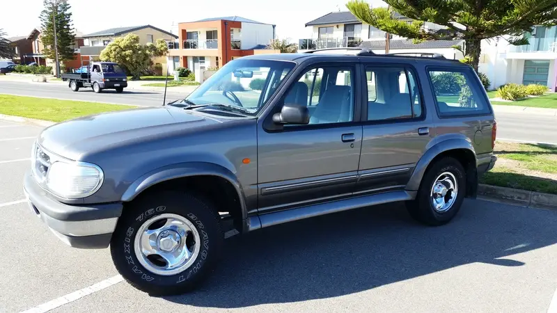

A few pics of my recently acquired 1998 XLT
OK, here she is..... The car actually needs a really good clean so i was surprised the she looked so shiny in the pics. I had made a quick attempt at the interior before i took the pictures but don't want to spend to much time on the car just now. Mainly because it seems to have a couple of suspension issues i want to rectify before spending money elsewhere
Anyway, here she is:
