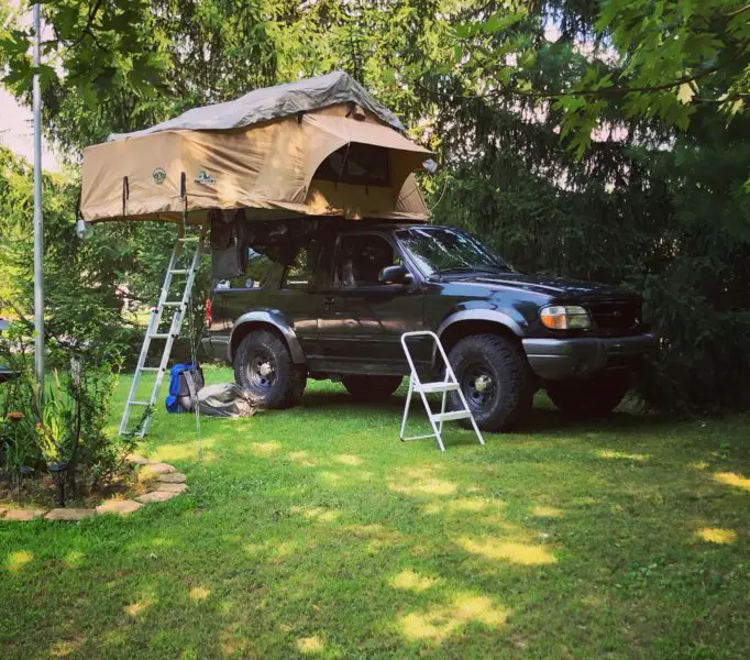

Thanks for the reply. I wish I could join you all but we are headed to Yellowstone and the Tetons in midJuly. I read up on the "frankenpacks" The Explorer is just a toy and when I started building it, I was inspired by the Gambler so a set of Deavers or similar would be against the original plan. Although we are well past common sense with this build, people keep telling me I'm crazy but I keep driving and the Mule keeps running. 173k and counting. I'll probably just do the 4 door replacement leafs and bumpstops. I'm also worried about the monoleafs breaking at some point.

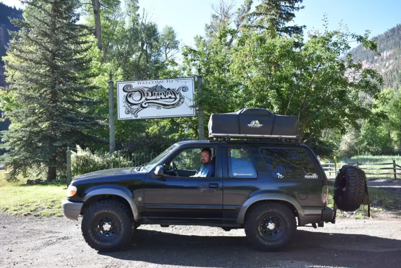

Enjoy Ouray! We had a great time on the Alpine Loop and Mineral Creek was awesome. We even ran into Diane Keaton in Silverton.
(This pic is NOT from that trip)
