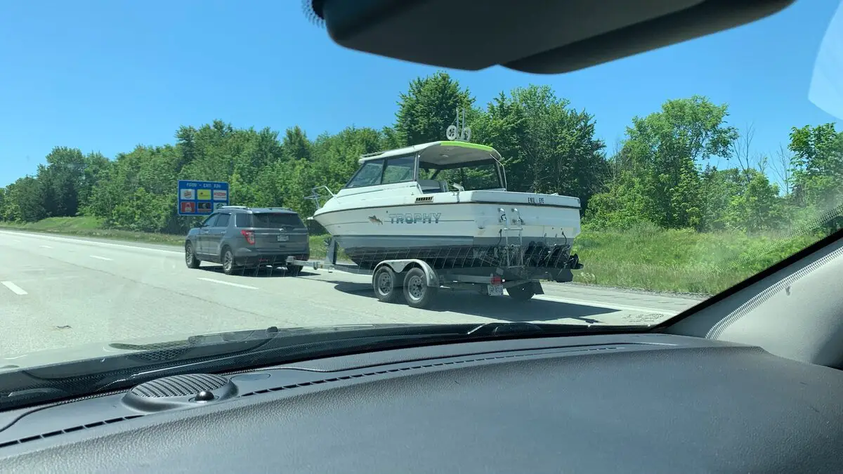

Are you trying to tow something that exceeds the factory tow rating? I'm not sure that's a good idea. Even if you could beef up the suspension to (theoretically) handle a higher tongue weight, you still run the risk of overheating your engine, transmission, and brakes which wouldn't be very safe. In particular, these transmissions aren't what I would call "heavy duty" and there's very little available to "beef" them up. 2012 had a Class III towing package as an option. I don't know what drivetrain you have but here is the towing chart from the owner's manual:
Tongue weight shouldn't exceed 10-15% of the loaded trailer weight. If your loaded trailer is over 3500lbs and/or you're getting excessive rear axle sag like in your photo, you may consider a weight distributing hitch:
https://www.etrailer.com/faq-weightdistribution.aspx
Towing information starts on page 248 of the owner's manual:
https://www.fordservicecontent.com/Ford_Content/catalog/owner_guides/12expog2e.pdf

I use a load distributing hitch and respect the 5000 pound tow capacity.
