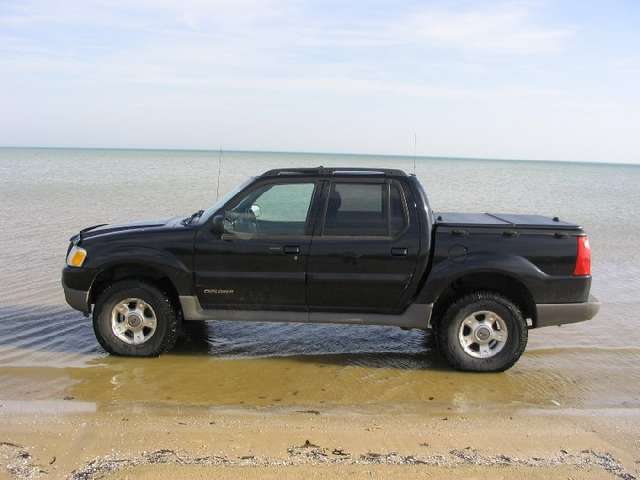

Heres mine with TT & shackles and 285/75/16 BFG AT,s(about 33")
