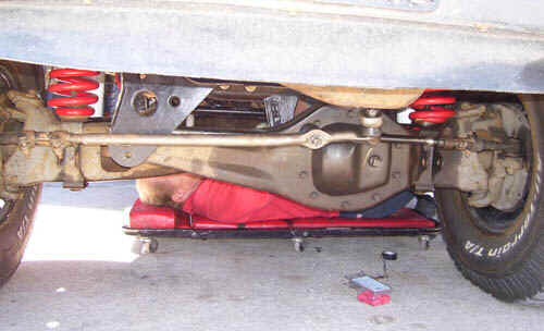

You sure about that? This is a Superrunner kit at just 4" lift... Seems a little off if you ask me. :wtf:
Did you modify yours by dropping the centerlink down?

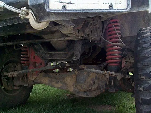

Way better than with stock set-up... did you ever drive an "X" with 6" lift, stock steering and no anti-roll bar? Scary... and with superruner I was able to cruze at highway speeds no problem... I mean European highway speeds - talking about 90-100 m per h.
Here's mine... 6" Skyjacker with Superrunner steering... just dropped pitman arm, that's all.
the supperunner itself minimizes bumpsteer, but it is not the perfect solution, really to get it perfect u need a custom steering setup. Supperunners a step in the right direction, dropin the centerlink of it is a step further.

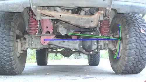

true... custom set-uo would be best but just look at the difference between those two... here's my former truck, also a 94 with 6" Skyjacker... and stock steering (including dropped pitman arm)...

This is about what you want it to look like when you use stock suspension and a drop pitman arm
Front-suspension-shots 002 by maniak_az, on Flickr
BUT, even with ours that flat when really twisted up the steering just doesn't work. I ran into that a few times this last weekend at truckhaven when I was at max droop/stuff (crossed up). I just couldn't steer.. Of course, it was on a night run which just made it more interesting. :)
Aparently Bkennedy also has that issue on his suspension and he is actually running the superrunner steering so I think it is more of a TTB issue than steering "type" issue.

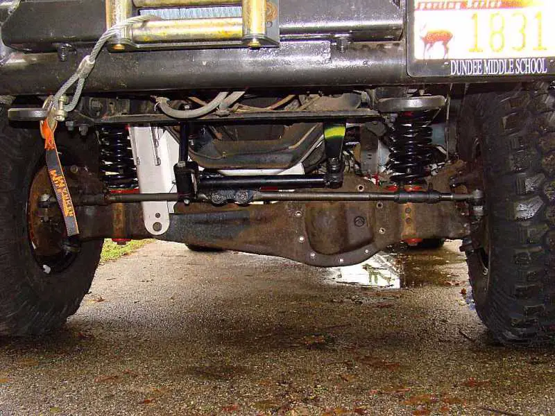

No argument from me... The Superrunner kit is still better than stock w/ a typical drop arm, but the longer Skyjacker #FA600 arm puts the steering at an even better angle yet (dead-perfect for 4" lifts). You would have to drop the Superlift centerlink down a couple inches to get the geometry to be correct on it (if a person is open to performing such a mod, then I normally recommend going that route, as it doesn't put as much leverage on the steering box as the long SJ pitman arm would, however with Stonecrusher's new TTB linkage having hit the market recently, I'd be very tempted to go that route instead.
4" lift w/ SJ #FA600 (extreme) drop arm:
A corrected Superlift Superrunner steering kit:
By the looks of yours, you could move your axle to the upper hole and improve things a slight bit (combine that with a 2" drop on your centerlink and you'd be perfect) ;)
Maniak, have you checked that something wasn't binding? (that steering stabilizer maybe?) I can't say I've ever run into a situation that I couldn't steer well on the various setups I've had...
