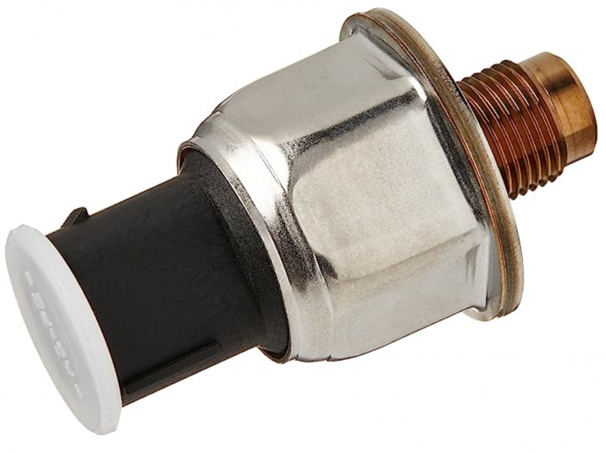

The 3rd gen and 4th gen Explorers/Mountaineers mostly share the same components. The same brake fluid pressure sensor is used in all V8/V6 Explorer/Mountaineer models from 2002-2010. Also, the master cylinders from 2002 to 2010 are virtually the same. This leads me to believe the pressure sensor is located in the same area. The sensor looks like this:
Eddie, there are no opening on this Master Cyl to take a screw in pressure switch.
I just checked my master cylinder and the surrounding area. I couldn't find the brake fluid pressure sensor either. I wonder if the 4th gens incorporated it into the ABS system but then why would their be a part number for it as a separate component? The image I posted above is what it should look like and is the same part I replaced in my 2002 Explorer. I think you will need to look at a service manual if you can't get an answer here.
