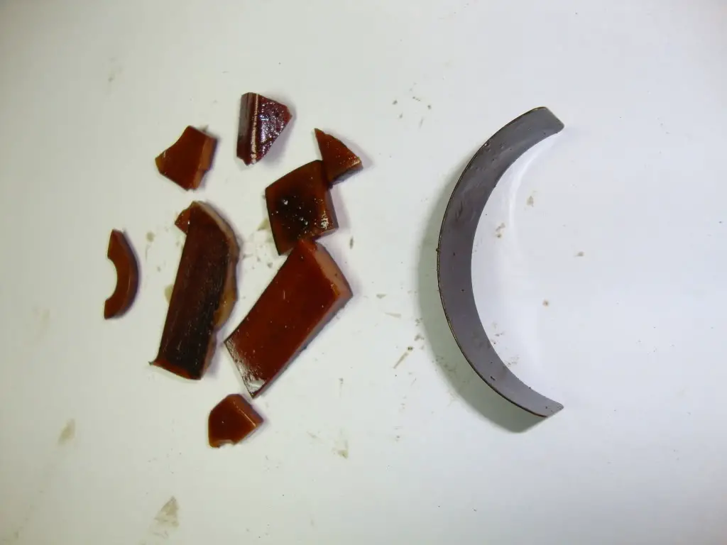

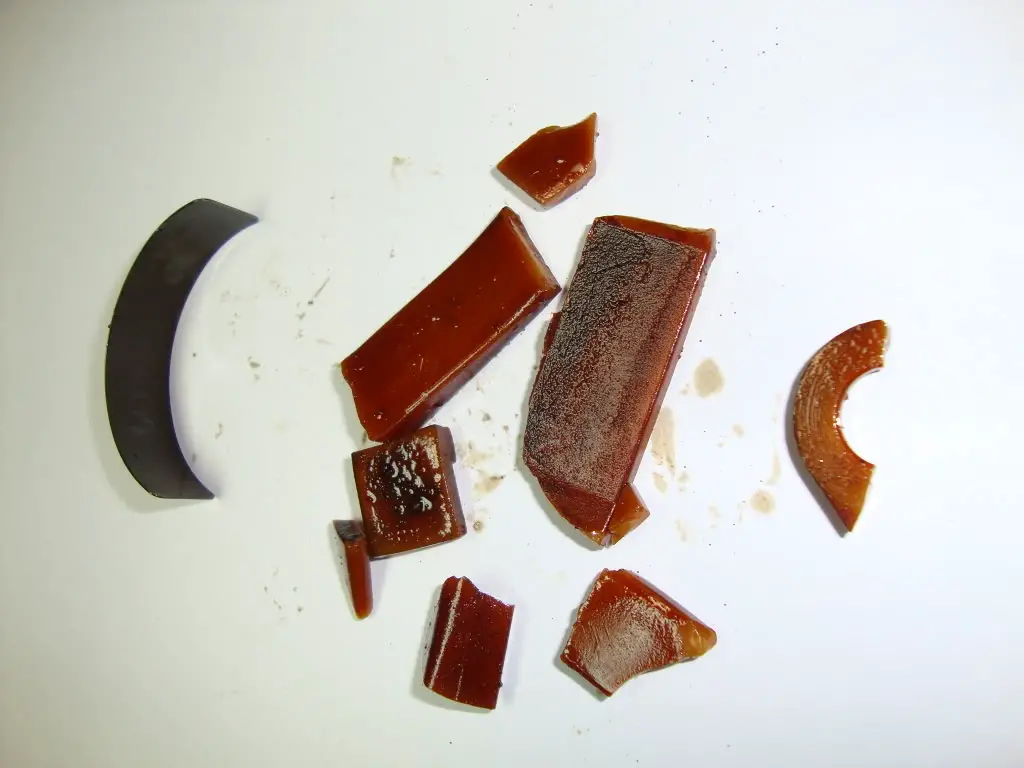

First off, I want to thank all for sharing their knowledge here. Because of you, I was able to do the following on my EX myself: replace plugs and wires, upper and lower balljoints, torsion bar end links, shocks, outer tie rod, and a few other stuff. My EX has 228k miles bought two years ago when it had 216k. It runs great. Not having any problems right now. By the way, it is a '98 4.0 SOHC XLT 4x4.
Now, the reason for the post. Oil was leaking in the pan area so I figured I'd change the pan gasket and the oil pump screen. Imagine my surprise when I dropped the pan and found these. I'm familiar of the "death rattle" and what's causing it but it didn't really sink in until now. I know what the plastic pieces are but what is the metal part? It's about half inch wide and about 2.25" end to end. How much longer longer does my EX have? I'm sure that's a million dollar question. Thanks for your reply in advance.

The metal piece is a spring for the timing chain guides, with those miles your engine does not have longer. you could fix the current engine before it total destroys itself.
Another option is a used late model Mustang 4.0 engine, or any later model used 4.0. you dont want another early design used engine as it will have problems like you have now.
The metal part is a leaf from the jackshaft tensioner.
The plastic parts are from one of the cam chain tensioners.
No way to tell how long it will run - you could go another 100k, or it could blow up tomorrow.
If you have the tools, time, and a little bit of talent, I'd tear the engine down sooner rather than later. If you drive until it dies, you could end up with more serious and expensive problems (bent valves, etc).

Thanks for the replies. At $2500, it's painful alright but I, too, love my truck. One thing I would like a definitive answer on is the metal part. What exactly is it? Is it part of the timing chaing guides or something else in the engine? Would like to know exactly what it is. Thanks.
