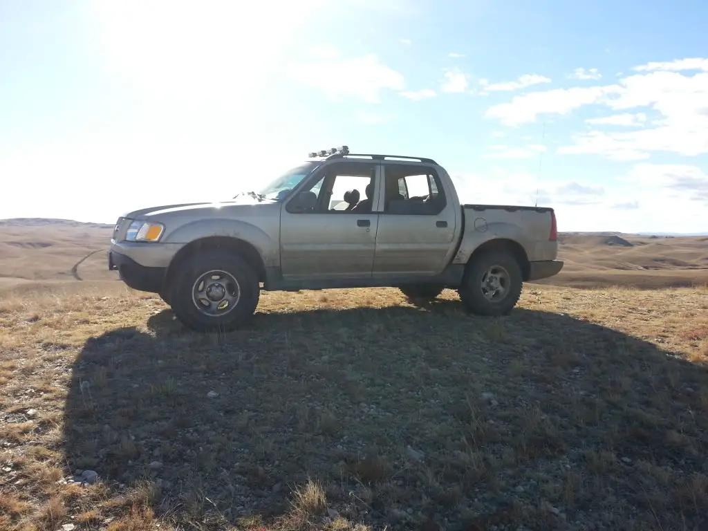

this is what 265/75R16 stock rims and 1.75" lift looks like
