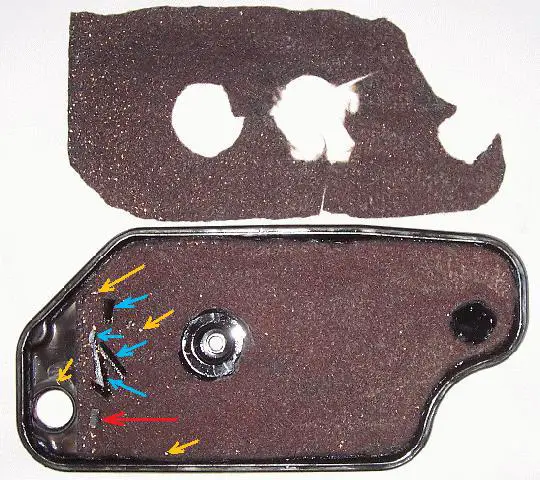

check the filter
On my 5R55E that had the 1>2 upshift flare I cut open the transmission filter to check for particles since there were no large metal particles in the pan or drained fluid.
The yellow arrows identify brass particles that I think is just normal wear. The blue arrows point to gasket pieces and the red arrow is a bracket piece. I replaced the blown valve body separator plate gasket and broken solenoid bracket and have been driving for three years with no problems.

tin snips?
I can't remember but I may have used tin snips to cut the top off of the filter. I didn't have much friction material in the pan.
