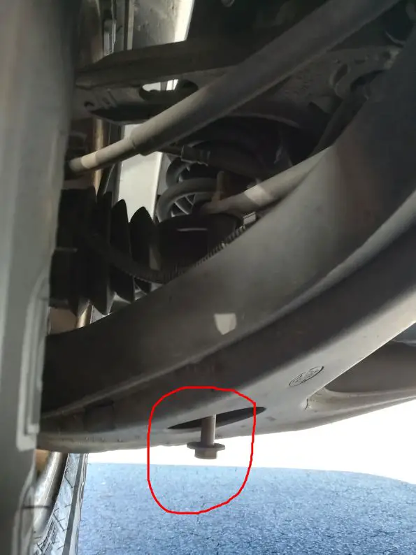

Anyway, I had my truck at the dealer. It broke down with the Failsafe engine message. They replaced the crankshaft position sensor, the crankshaft pulley, and the belt. They made a note on the invoice that said "Recommend Suspension Diag" . I was looking underneath it and checking the tires because after I got it from the dealer, I took it to another shop to get tires and now I am hearing an sporadic buzzing noise that I don't think I had before. I am not sure are the new tires.
While looking at the wheels and tires, I notice it has these bolts that are loose in the back on each side. Very loose. I don't know if the dealer loosened them to look at suspension or what. Any ideas if these are supposed to be dangling?
That looks like the sway bar linkage, and its missing the bushings. Its a bi-annual event for me replacing those. Wonderful design. I can swap them in under 15 minutes now days I'm so good at it.
Why so often?
They are a common failure item. When they wear they can clunk and squeak, and be annoying. If the bushings are totally gone as in your case, you essentially have no sway bar functionality, and will have increased body roll.

You don't but it makes it easier than having to crawl underneith. You can change it from the wheel well if you pull the tire. Also, a sawzall or a grinder works wonders if the sleeve is frozen. Usually knocking off the bolt head after removing the nut and pulling it through. It can be done with a band saw in a pinch but it takes forever.

Hardest part might be removal due to rust. That top nut might be frozen on there, will take forever to remove, or might just twist off. Consider applying a penetrating lube like PB Blaster to that top nut days before removal. Apply daily.
