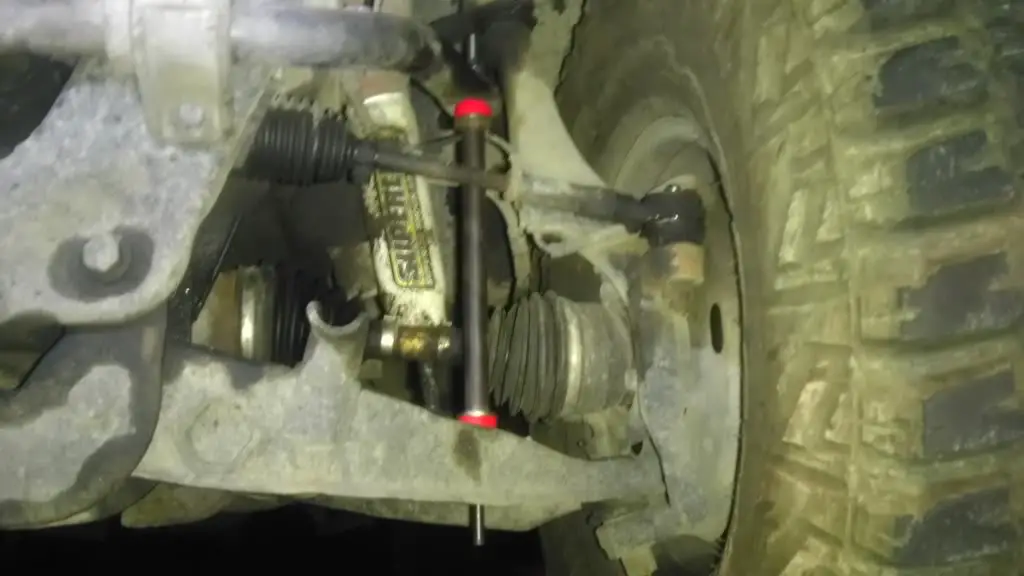

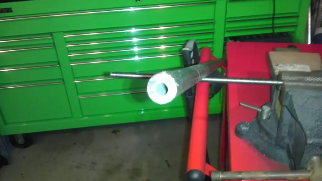

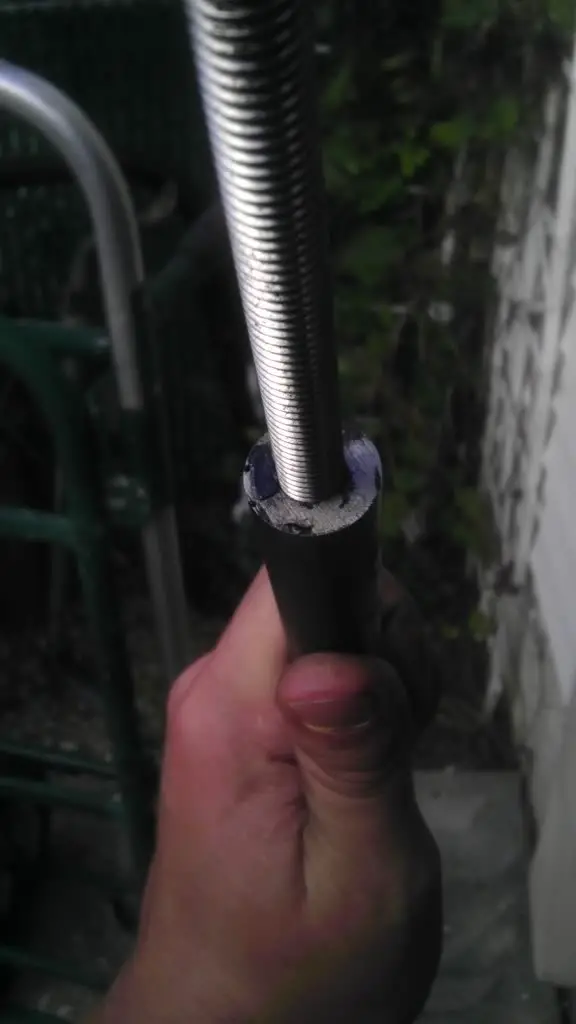

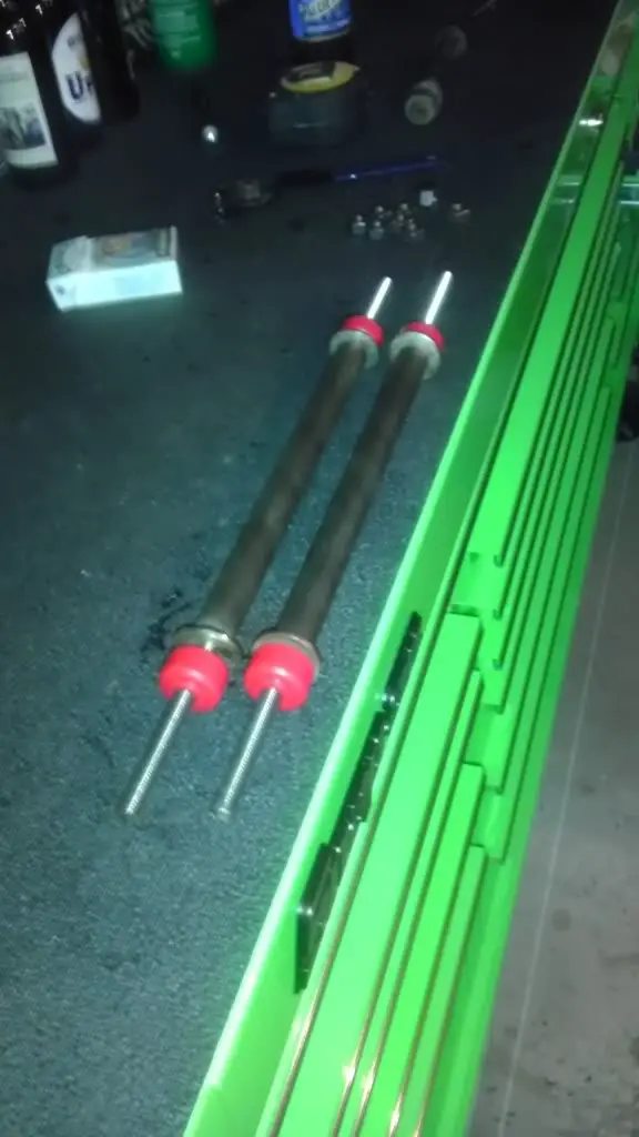

Thanks to a thread that was made a few years back I went ahead and made sway bar endlinks for the super lift. I picked up some beefy 3/8 pipe 5' length for $5 and a 6' length of stainless all thread for $4, energy suspension bushings for $12 as well as 8 nuts for 35 cents. I have enough left over to make another set. The truck handles like a dream especially with no sway bars for a year! Id advise anyone 5 years or older to do this. Its easier than making grilled cheese!!!
I had them off due to the lift kit. I got the kit second hand from my buddy. His lift for my stock suspension if I did all the work swapping them. He never had the links or he bent them somehow. Id be more than happy to make a set or 30 to sell. Half the price superlift sells them for, tougher and better bushings
Theres one for sale... In the for sale section lol! It's funny I always doubted it was a 4" lift.... Well the endlinks I made are exactly smack on 4" longer than the stock one
