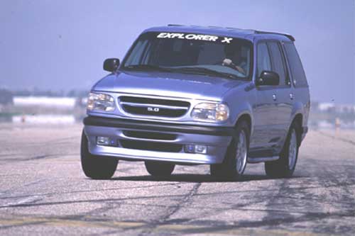

We have some experience with the air ride suspension models. There is an advantage to disconnecting the air ride system and switch to the Edelbeocks. All you have to do is disconnect the shocks and remove the fuse for the air ride compressor. This may cause a warning light to come on. The special Edelbrock's perform much better than the stock air ride type and offer a better ride. Firm but not bouncy. The air ride models sit lower in the rear when the air ride is eliminated. Many owners have had success with not installing the lowering blocks at the rear and lowering the front only. If you carry heavy passengers or cargo regularly, we may substitute the rear Edelbrock shocks for the Monroe Load Leveling Shocks. These have built-in coil over springs to help keep you from bottomong out. This front only lowering with the special shocks and X-Spec Sway Bars will give you the rake you want as well as awsome ride handling!
The stock air ride systems has sensors and is designed to lower when the vehicle is turned off. The idea of controlling the system for ride height would require changing some of these components.

The shocks we sell would be a direct replacement for the air ride shocks. For you I would recommend using the Monroe Load Leveling Shocks at he rear. We could set you up with a kit that would include everything required for the job. It would be custom tailored for the air ride model. Keep in mind you, you may get a warning light on the dash after removing the air ride fuse.
