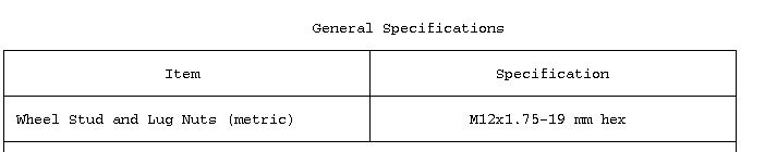

Anyone happen to know the tread pitch? I searched and could only find that it's 19mm but no thread pitch. The PO rounded off one of mine :mad:. Had to use the BFH and socket to get it off.
19 mm is the size of the flats on the nut. 3/4" = 19.05 mm, so you can also use a 3/4 socket. The actual stud size is 12mm x 1.75 mm thread pitch.

Really? I thought about that, but I seem to remember that my 89 Ranger had metric studs also. Anyway, the chart is from the 97 FSM.

Oops, forgot to say.
It's for my 91. Good to know, because the parts store didn't have any 12mm x 1.75. They had some 1/2 x 20 nuts though.
Thanks again.
