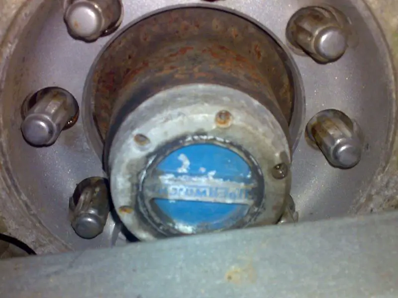

here are some pictures the seller sent me of the D44:thumbsup:

Could some one help me with some good locker options for the axles?
Guess the D44 is from a F150 and reverse cut?:eek:
A reverse cut ring and pinion set is not hard to find and does not effect type of locker you can use.
The only exception being a Detroit true-trac. If you choose the True trac you just have to remove the end caps and put the left one into the right and the right into the left including the worm gears. Sounds complicated but YouTube videos abound on the procedure.
Also be sure to verify the locker is compatible with the gear ratio choice. Again most fit 3:73 and lower. Higher ratios such as 2:73 get to crowded as the ring gear thickness gets larger. I'm sure you'll be going with 4:56 so should be no problem with even the larger locker designs.
Simple "lunch box" lockers work with nearly anything but are a horrible driving experience. For best on highway performance and least steering pull it's the True-trac hands down. For select-able full locker and ease of install the e-lockers rule.
Any brand will have several solutions for the D44 front. (left side diff)
http://www.summitracing.com/search/...axle-model/dana-44/ring-gear-rotation/reverse
http://www.summitracing.com/parts/aub-545018
This online store is not the only choice of course but you can use it to get some research done..:thumbsup:
For snow the True-trac wins again.
Auto lockers and lunch box are undriveable in snow.
So, e-locker, air-locker or True-trac would be the best all round choice.
I see 8 lugs in one of your pictures, so that's a 3/4 ton axle, not an F150.
