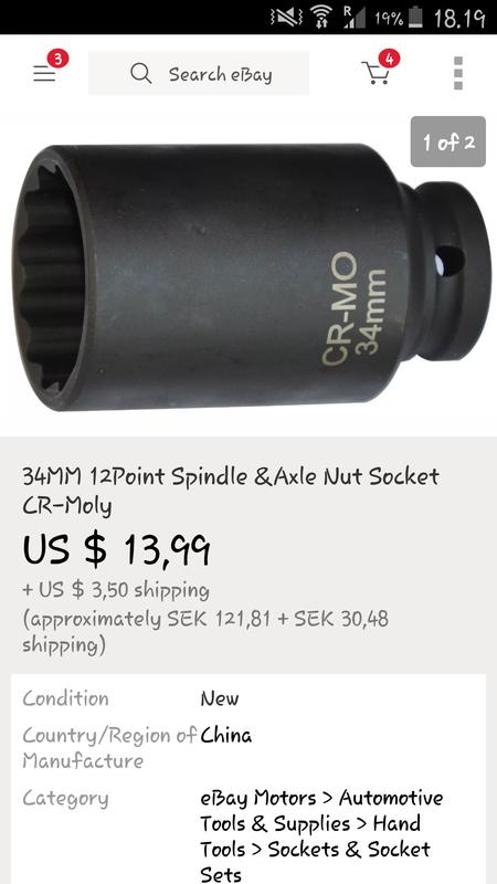

Hope i can get the dana 60 pinion nut out with this :eek:

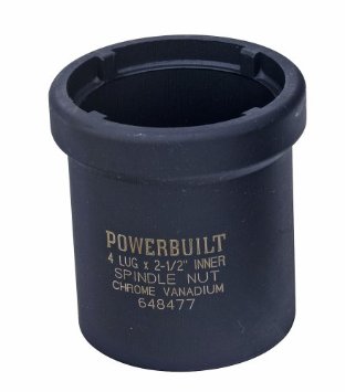

For the D44 spindle nut socket, I have had better luck with this type of design.
It allows a more solid connection that doesn't slip while applying high torque.

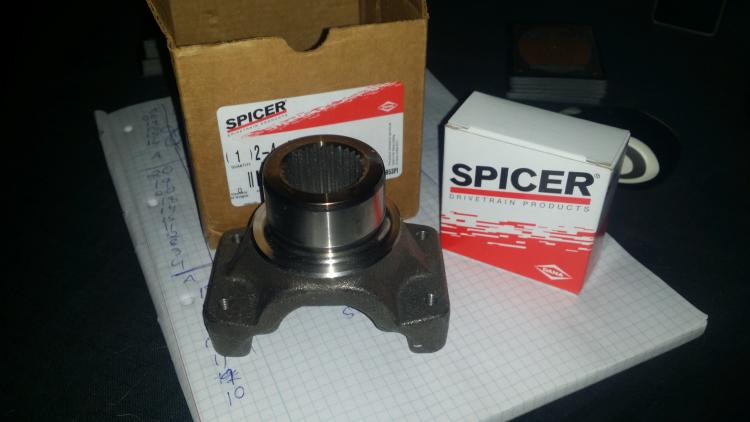

It's the pinion nut i need to get out. . Will get a new pinion yoke so i don't need to get ******* u joints or a new driveshaft :thumbsup:
Know the size is 1-5/16" .. Thats wery close to 34mm

And i got the pinion nut out so i could put on my new pinion yoke:thumbsup:
