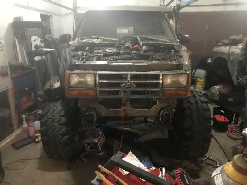

hey guys, does the maf sensor have to be a certain distance from the throttle body to run right? i just doved the front body of my explorer and had to run the intake to the drivers side instead of the passenger side for clearance, Has anyone done this before? just finishing up cutting the fenders so i have not ran or driven it yet! thanks
