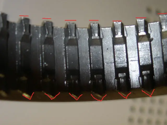

New trans fluid in a Manual Trans won't help a hard shifting problem. They use bronze synchronizer gears to mesh the gears while shifting. When they are new, they are flat on one side. And Triangular/Pyramid shaped on the the other. They mesh with a steel ring that has the same triangular/pyramid shape all around the ring.
When a synchro goes bad and isn't fixed, it only costs more to fix it later. As you have to replace the more expensive Steel Ring and or other hard parts...
Here is a pic of a Selector Ring that had a bad synchro and wasn't fixed. Eventually it became IMPOSSIBLE to shift into reverse. The 5th Gear side was PERFECT, with sharp points still intact. The Reverse side was FLAT.

What you're describing sounds like syncros to me since it is only affecting certain gears. You can get every part seperate in that tranny if you want to. You might want to look at getting a junk yard one and rebuilding it or see if you can find a brand new one. Seen one on ebay one time. Or a later year M50D. They used them up to at least 2001 I think. Straight up Mercon ATF works fine in the tranny. You could use V if you really wanted but why pay more for a synthetic.
Yes. You can get synchro's for the 1-2, 3-4, and 5-R...
But like I said, the synchro is the SOFT part of the assembly that is designed to take the brunt of the force to slide the steel ring into just the right position before engaging into the desired gear.
But if the synchro is worn, and you force it into gear, you aren't grinding the synchro, you are grinding steel to steel....that gets REAL BAD real fast.
