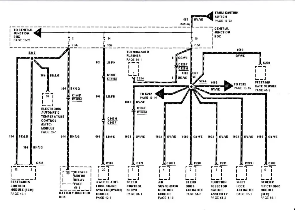

Many Many thanks to Roger, Just spent a day with ripping the guts out of the inside and outside of my car trying to find out why fuse's 10 and 18 keeps on blowing, We have disconnected and checked each relay, arc, pcm. disconnected everything we could find that was feed from 10 and 18 but all seem fine , but still not working. As the light was fading we decided to call it a day and put everything back, scratching our heads, the only thing we could not find was the splitter S244 (where all the grey and yellow wires part) Does anyone know where this is please? so I can isolate everything from the start.
We have managed to by pass the suspension control unit so I can get the compressor to work via switch.

Just a shame we couldn't find the damaged wire. I think it has to be rubbed through somewhere, but where?
Keep on looking and you will find it.
Probably in the connector by the drivers footwell?
Looked very iffy...
Just a shame we ran out of daylight.
Looked very iffy...

If we can get our 4wd working again - and the central locking & power seats - then yes - I'd be interested :-)
