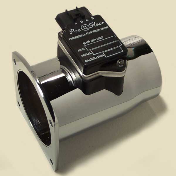

The mass air sensors are similar, the main difference is the elt.connector. There is a 4 pin style and a 6 pin style. Obviously they need to match. Ford changed to 6 pin 98-99. There is not a consistant production date as to when the change was made. If you ever update or change your MAF, be sure to check the connector.
John V @ EE
