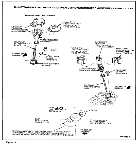

How do you sync it? Im thinking thats my problem right there! I didnt sync anything, i figured if the shaft didnt move at all it should be the same.
There is a special alignment tool. Did you just pull the old one and drop the new one in? Let me find some pics.
Yeah i did, I figured when it said alignment it ment with the shaft and the gear. I gotta drive it to work tomorrow, hopefully its not to bad and burns a piston up!
The tools are readily available at NAPA.

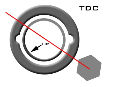

This is how I align mine with no tool. You just have to find Cylinder #1 TDC.
