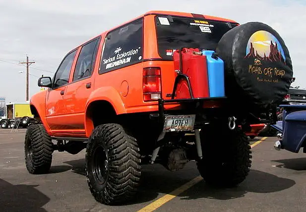

Ray Hutchinson is one of the people who has gone the Rancho 2" lift with 2" body lift, if you want any info about that, you could email him. He's a very knowledgeable person and a great guy. Paul Gagnon I believe runs a superlift and is also another very knowledge person. There are many pictures of lifted Explorers if you go to the home page and click on "add your Explorer". It will take you to some of the featured Explorers, then all you have to do is click on any of the names and you can see some really great rides. Hope this helps. If you want to get extreme than seek out our editor Rick and he can tell you all about putting a Dana 44 live axle in. Here's a couple of pictures of his truck.
