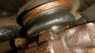

Moog ball joints are probably the most popular aftermarket replacements. I recently had an issue with both lower dust boots failing only two years after installation. I contacted Moog directly, and they replied the next day requesting a receipt. Amazon has digital receipts readily available on line and emailed Moog the copy along with the pictures below. Moog does not offer dust boots separately, and I didn't want to use the ES poly dust boots because they do not seal properly. Long story short, Moog sent me two brand new K8695T ball joints I received a week later, no return on defectives and no shipping charge for the replacements. Needless to say I am very pleased. I just hope the replacements don't have the same dust boot issues.
Hmmm...my dust boots on the lower ball joints failed too but I let my shop do them when I didn't have time. My shop receipt doesn't show a part number unfortunately but I do know they're Moog. Oh well, I just regrease frequently until I have time to replace.
run all Moog parts and any that have failed have been replaced free of charge no questions asked
Must say I was extremely pleased with Moog's customer service, however I don't look forward to replacing ball joints every two years due to failed dust boots. If you look at my pics closely, the left boot ruptured on the bottom, right side rubber is cracking. Neither failure was caused by over filling, I always stopped immediately after grease started coming out of Moog's "grease relief valves" that were facing inboard. I've also read here that Moog's tie rod boots have the same issues. Wouldn't be so bad if a $70-$100 alignment wasn't required after replacing most steering or suspension parts. ($20 tie rod)
