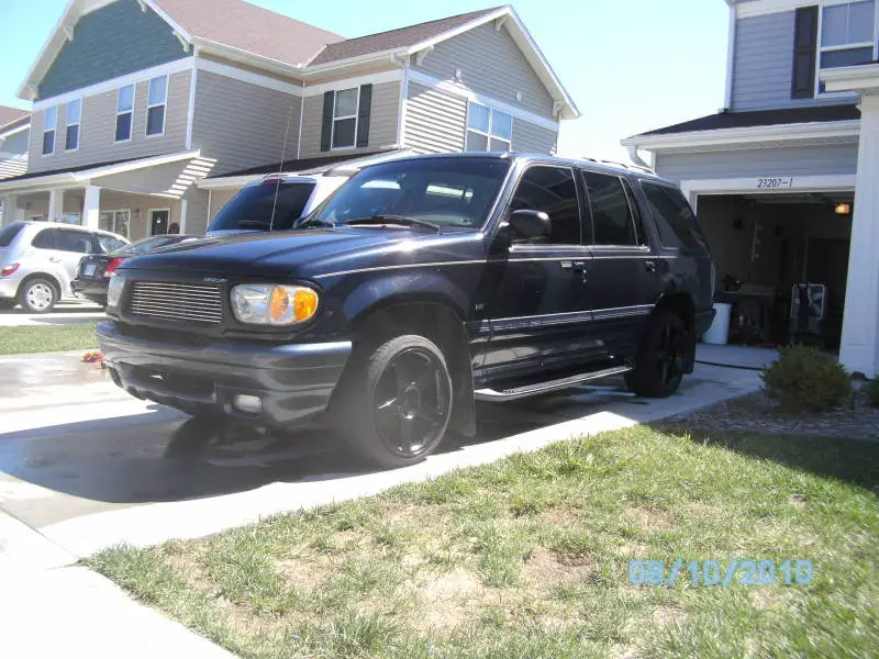

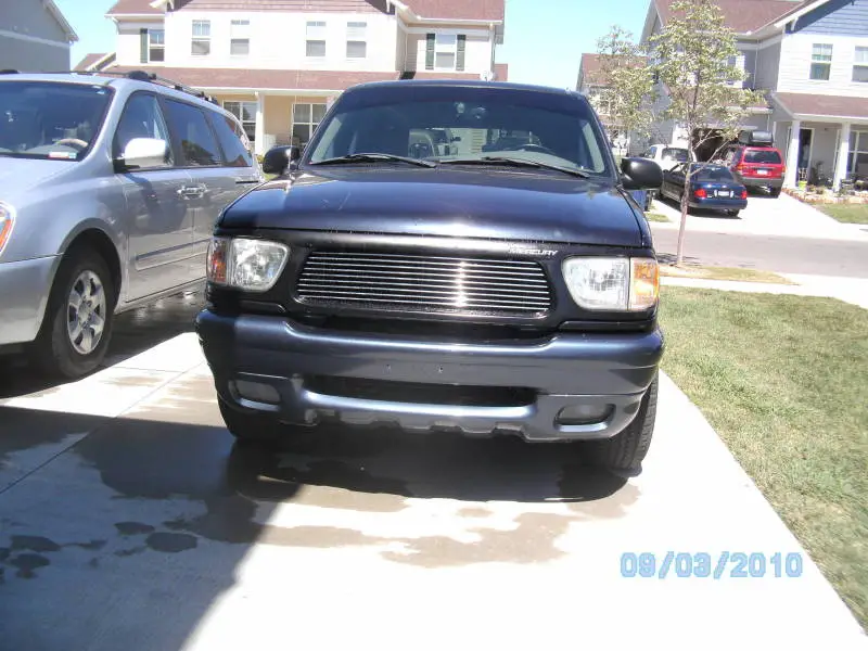

i couldnt find one so i took a 95 Ford Ranger billet grille and made to fit was actually easy to do had to customize it by bolting to the top of the grille but there covered by top plastic when all back together

you have to custom make one there is no inserts that i have seen if u look up at my first post i used a 95 and flipped it upside down, fit good with minor cutting 1996explorerxlt did his different so he may have a different way to do it. I say find a JY get a grille for cheap cut it up and practice with it. get measurements from other vehicles like ie F-150, the rangers, S-10's etc.

yeah mine does have the [ shape on top but barelly noticable i got to finish sanding my grille down i just sanded where needed and threw some primer on untill winter so i can sand it all the way down and paint it. I like the bumper on your truck better then the mountys fifty150. where ya locate that one at?

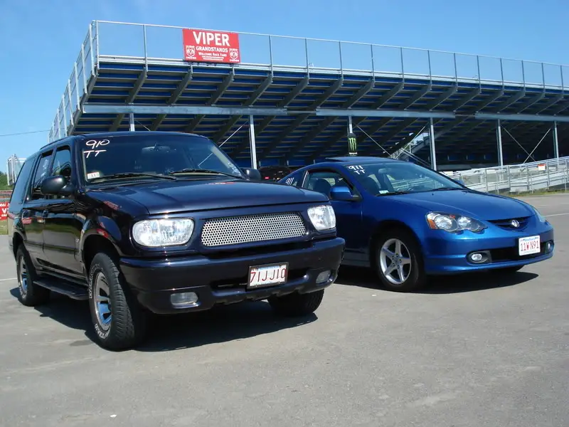

My custom grill:
It used to be chrome too. I cut out the vertical slats and ground the edges smooth, painted it, and cut out the mesh to fit from the inside and painted that black.

dylan.C.1021 ill get pictures where i bolted mine at in few days, its cold as hell out all week,
and 1996explorerxlt i used a 95 ranger grille there a bit longer then the explorer grilles i believe.
mounty71 i thought about doing it that way but dont like that it can see right thru my own preference
Ya i'd also prefer if the mesh was a little denser so you couldn't see through it so easily, but it's all i could find that was cheap.
