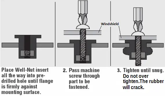

A decent/easy way to secure the rack to your roof if you don't have the stock rails is to use "well nuts"...You would fab up your rack (or just mounts for an existing rack), then drill the holes in your roof, drop in the well nut and tighten down the bolts into the roof. The well nut works kind of like a molley, sandwiching the roof sheetmetal as you tighten it. The flanged rubber top will seal the rain out. Should be available at your local Lowes or fastener store. Just make sure the hole is deburred with no sharp edges or the sharp metal will slice the rubber wellnuts eventually. Easy enough to replace them tho. If you are lazy/feeling lucky you can just decide where you want the mounts and go to town drilling your roof, but probably a safer bet to drop the headliner to pick the best spot to drill and have the mounts (aka not right on a structural rib on the stock sheetmetal framework where the roof meets the walls)

really just quoting this so I can reference these wellnuts easier. Great idea
