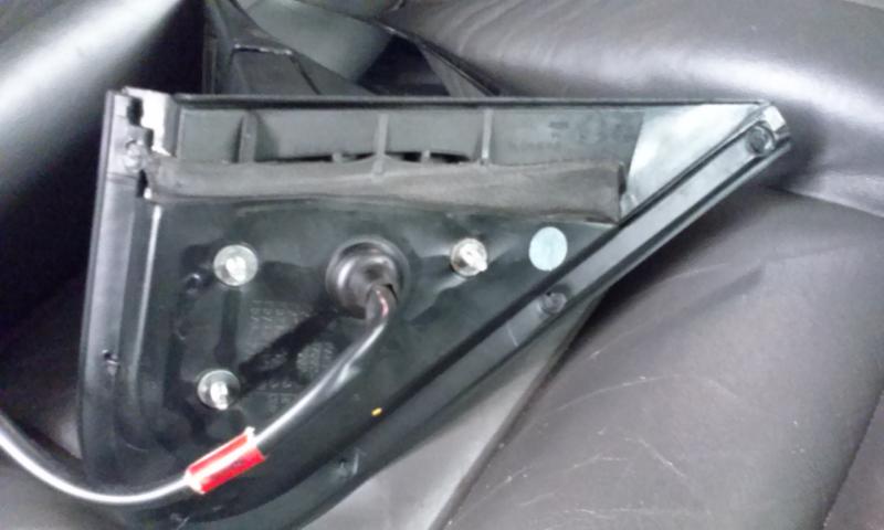

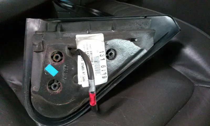

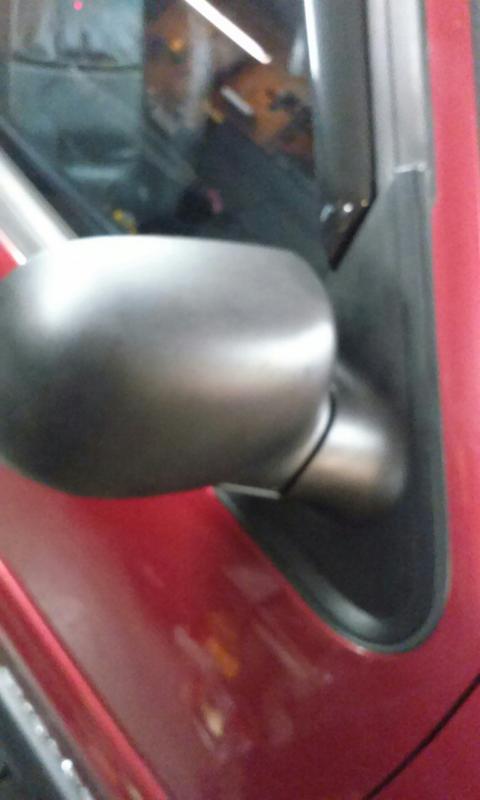

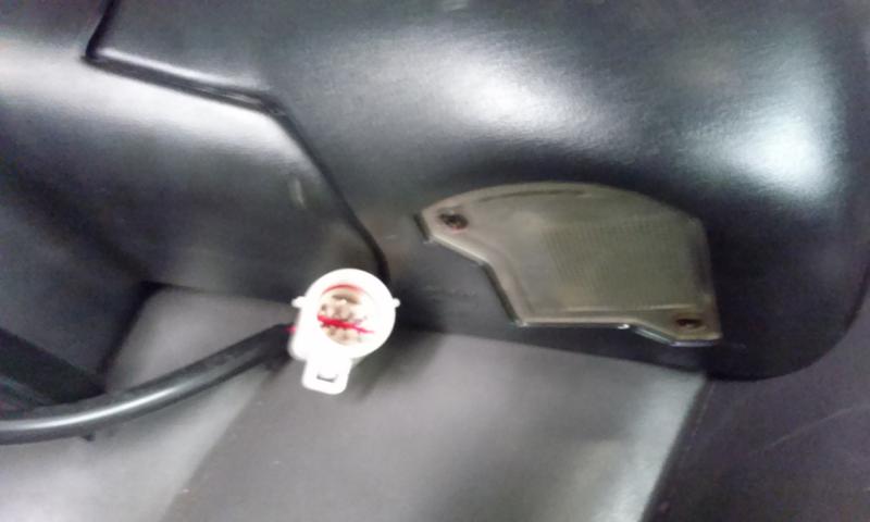

Well since I have the donor Mounty at the house I decided to take the mirrors off and try them on the ST. Both trucks go to have the V8 swap next weekend. It is not a easy direct swap as it required wiring which I am not done with yet and the trim areas don't match up perfect.

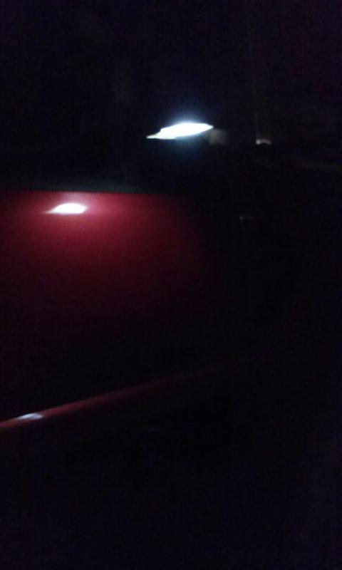

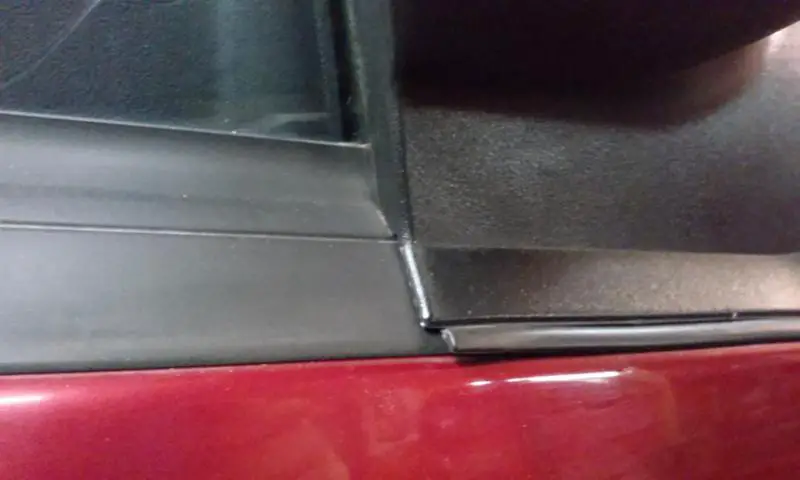

So after I got them mounted I had to try them, I ran the wires on the passenger side to an extra battery I have and just hooked it up. I still don't have the drivers side wire ran yet as I am trying to figure out how to get the wires though the door into the body. I am still not sure where I want to run the wires to, thinking a switch so I can have them on when I want them. The other pictures are of the fit of the mirror to the door, not perfect but decent after a little trimming. If anyone knows how to get the extra wire though the drivers door let me know. On that side I also have a short I guess because when the door is fully opened the interior light and key chimer goes on and off.

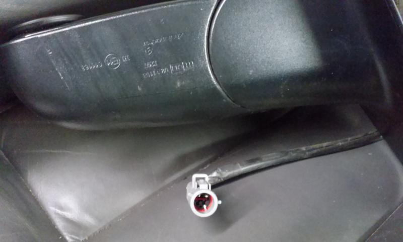

Definitely not plug and play. the plugs and pins match but the fourth wire pin will be empty. The wiring is simple if you already have power mirrors as you only need to run a triggered hot for lamps. I tapped my dome light. Each mirror plug end has two motor hots, and a ground. The 4-5 wire is for puddle and heated.

the plugs match and the standard three pins that your power mirrored trac have match the puddles and/or heated. issue is running a single wire from your dome, switch, keyless entry, etc. its not a hard upgrade from a factory trac w/ power mirrors.

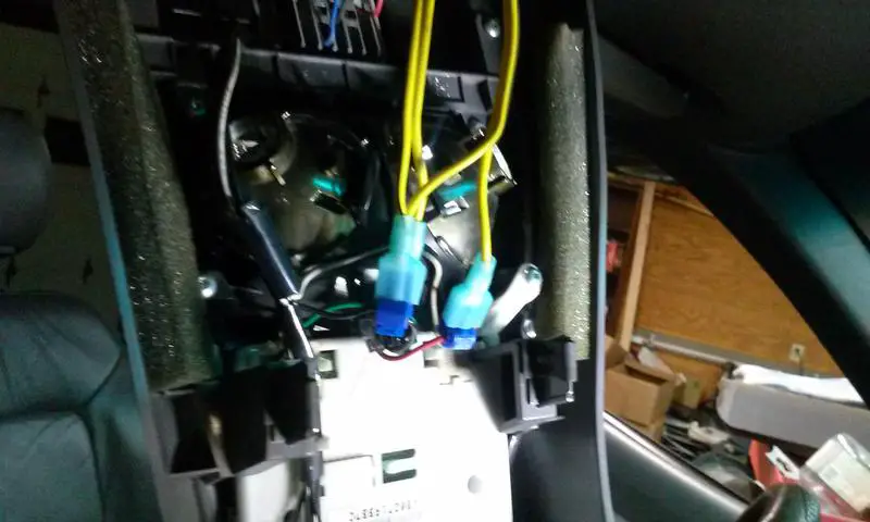

Update: After having an engine but in my ST I finally got around to wiring the mirrors up. I decided to run the wires (I used good grade speaker wire) to the front dome lights. This way they come on when I hit the power door locks, open the door and I can even turn them on independent of each other with the buttons on the front console. I T taped into the positive wires independent of each other and used one as a common ground.

That's a neat idea of running them off the map lights
Good idea, just watch the wires being that close to the lights. They get really hot.
I am running led bulbs in both the overhead console map lights and mirror puddle lights to keep the heat to a minimum.
Smart.
